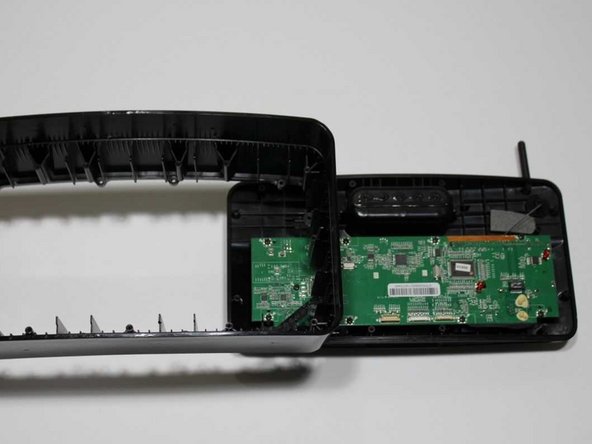

    • Use a Phillips #1 screwdriver to remove the thirteen 12 mm screws in the speaker frame.
    • Remove the four screws at the bottom of the device
    • Remove the speaker frame by pulling vertically upwards revealing the motherboard.

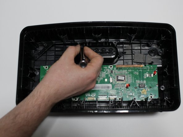

  3. Pioneer A1 XW-SMA1-K Antenna Replacement: crwdns2935265:03crwdnd2935265:01crwdnd2935265:03crwdne2935265:0 Pioneer A1 XW-SMA1-K Antenna Replacement: crwdns2935265:03crwdnd2935265:02crwdnd2935265:03crwdne2935265:0 Pioneer A1 XW-SMA1-K Antenna Replacement: crwdns2935265:03crwdnd2935265:03crwdnd2935265:03crwdne2935265:0
    • Use a Phillips #1 screwdriver to remove the twelve 12 mm screws from the middle frame.
    • Remove the middle frame by pulling upward and vertically.

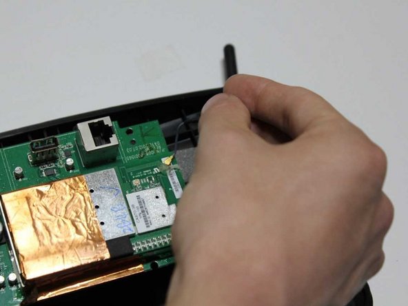

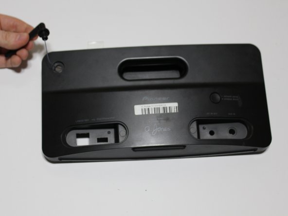

  6. Pioneer A1 XW-SMA1-K Antenna Replacement, Antenna: crwdns2935265:06crwdnd2935265:01crwdnd2935265:02crwdne2935265:0 Pioneer A1 XW-SMA1-K Antenna Replacement, Antenna: crwdns2935265:06crwdnd2935265:02crwdnd2935265:02crwdne2935265:0
    • Flip over the back panel and pull the antenna up and out.
