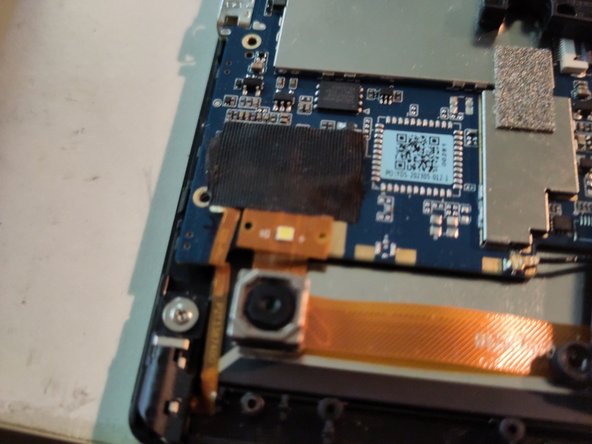

  5. Pine64 PineTab 2 Touch & Front Glass Replacement, Remove the back camera holder and headphone jack: crwdns2935265:06crwdnd2935265:01crwdnd2935265:02crwdne2935265:0 Pine64 PineTab 2 Touch & Front Glass Replacement, Remove the back camera holder and headphone jack: crwdns2935265:06crwdnd2935265:02crwdnd2935265:02crwdne2935265:0
    • Unscrew and lift aside the black plastic that holds the back camera in place
    • The camera itself can remain
    • Remove the washer screw holding the headphone jack in place (next to the camera)
