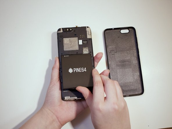

  2. Pine64 PinePhone Charging Port Replacement, Remove the back cover: crwdns2935265:02crwdnd2935265:01crwdnd2935265:01crwdne2935265:0
    • Using a fingernail pry open the back cover off with the bottom left indent.
    • A notch to easily remove the cover is located at the bottom left of the PinePhone with the back cover facing the user.

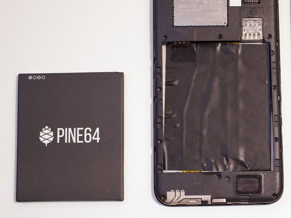

  3. Pine64 PinePhone Charging Port Replacement, Charging Port: crwdns2935265:03crwdnd2935265:01crwdnd2935265:03crwdne2935265:0 Pine64 PinePhone Charging Port Replacement, Charging Port: crwdns2935265:03crwdnd2935265:02crwdnd2935265:03crwdne2935265:0 Pine64 PinePhone Charging Port Replacement, Charging Port: crwdns2935265:03crwdnd2935265:03crwdnd2935265:03crwdne2935265:0
    • Using a Phillips #000 screwdriver, remove each of the screws around the perimeter of the PinePhone.
    • Remove the battery.
