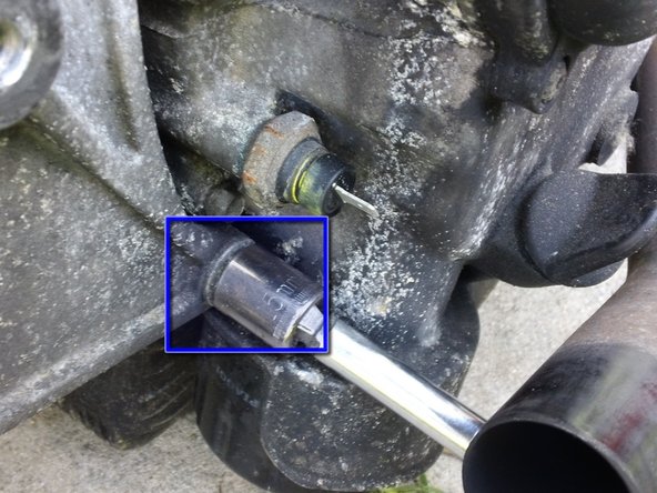

  4. Piaggio X9 500 Rear Wheel Removal, Disassembling Piaggio X9 500 Swingarm: crwdns2935265:04crwdnd2935265:01crwdnd2935265:02crwdne2935265:0 Piaggio X9 500 Rear Wheel Removal, Disassembling Piaggio X9 500 Swingarm: crwdns2935265:04crwdnd2935265:02crwdnd2935265:02crwdne2935265:0
    • Remove the 15mm nut securing the upper front corner of the swingarm.
    • Remove the 15mm nut securing the lower front corner of the swing arm.
    • Access to this nut is limited by the header pipe. A swivel extension maybe required to reach it.

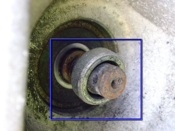

    • Straighten and remove the cotter pin securing the rear hub nut cover.
    • Don't worry about damaging the cotter pin. It is intended to be replaced each time it is removed.
    • Remove the cover from the rear hub nut.
  6. Piaggio X9 500 Rear Wheel Removal: crwdns2935265:06crwdnd2935265:01crwdnd2935265:02crwdne2935265:0 Piaggio X9 500 Rear Wheel Removal: crwdns2935265:06crwdnd2935265:02crwdnd2935265:02crwdne2935265:0
    • Remove the 24mm rear hub nut. Having a friend hold the rear brake handle will help break it loose. You can also use an impact wrench to remove it if you cannot get enough torque with a hand ratchet.
    • There is a spacer behind the rear hub nut. It will slide off with little or no force.
