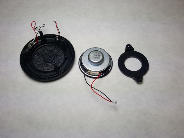

  3. Photive Rain Speaker Replacement, Speaker: crwdns2935265:03crwdnd2935265:01crwdnd2935265:01crwdne2935265:0
    • Carefully remove the front panel from the device.
  4. Photive Rain Speaker Replacement: crwdns2935265:04crwdnd2935265:01crwdnd2935265:01crwdne2935265:0
    • Detach the connector clips from the motherboard using the iFixit Opening Tool.
    • Some force may be necessary to remove the plastic clips.
  5. Photive Rain Speaker Replacement: crwdns2935265:05crwdnd2935265:01crwdnd2935265:02crwdne2935265:0 Photive Rain Speaker Replacement: crwdns2935265:05crwdnd2935265:02crwdnd2935265:02crwdne2935265:0
    • After the speaker is detached, remove the two 8.5mm screws that hold the speaker to the front panel with a Phillips #1 screwdriver.
