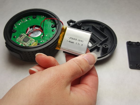

      • Turn the speaker off before disassembling.
      • Remove the suction cup from its groove by twisting and turning it.
    2. Photive Rain Battery Replacement: crwdns2935265:02crwdnd2935265:01crwdnd2935265:01crwdne2935265:0
      • Remove the four 8.5 mm screws from the back panel of the speaker by using the Phillips #1 Screwdriver.
      • Remove back panel
    1. Photive Rain Battery Replacement, Battery: crwdns2935265:03crwdnd2935265:01crwdnd2935265:02crwdne2935265:0 Photive Rain Battery Replacement, Battery: crwdns2935265:03crwdnd2935265:02crwdnd2935265:02crwdne2935265:0
      • Remove the plastic cover in front of the battery slot.
      • Unscrew all the 8.5mm screws that hold the cover to the slot.
      • Separate the battery from the back panel as shown in photograph 3.
      • Caution: manipulation of the device while the battery is still connected to the motherboard may result in electric shock.
    2. Photive Rain Battery Replacement: crwdns2935265:04crwdnd2935265:01crwdnd2935265:01crwdne2935265:0
      • Remove the battery from the motherboard.
      • Use a soldering pen to remove the solder connecting the battery wires to the motherboard.
      • Click here to access the iFixit Soldering Guide. This will provide a safe and instructive manual on the usage of soldering pens.
