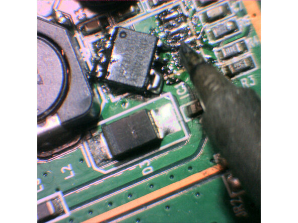

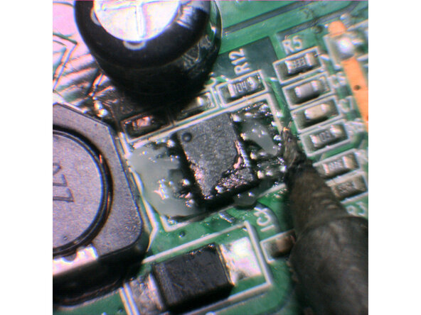

  8. Philips Wake-Up HF3520 Power supply repair, Soldering SO-8 IC: crwdns2935265:09crwdnd2935265:01crwdnd2935265:03crwdne2935265:0 Philips Wake-Up HF3520 Power supply repair, Soldering SO-8 IC: crwdns2935265:09crwdnd2935265:02crwdnd2935265:03crwdne2935265:0 Philips Wake-Up HF3520 Power supply repair, Soldering SO-8 IC: crwdns2935265:09crwdnd2935265:03crwdnd2935265:03crwdne2935265:0
    • These are the steps for replacing the IC with a soldering iron. For best result, need a good temperature-controlled station with a fine, but not too fine tip. Solder with about 0,5mm diameter, desoldering braid and flux. (Rosin) Flux is essential, as it makes the solder flow smoothly once the flux inside the solder wire is evaporated.
    • First picture show soldering wire and tip. Then, use solder to bridge all pins on both sides, alternatingly heating both sides until the IC comes loose. This may take some time (10s of seconds), but doesn´t matter as the IC is dead anyway. Do not use too high temperature. 360°C is ok.

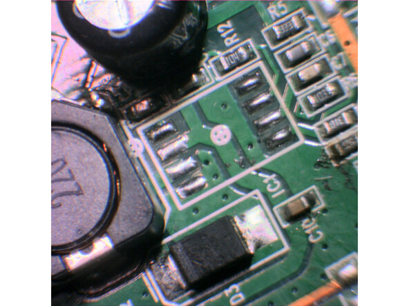

  9. Philips Wake-Up HF3520 Power supply repair, Soldering SO-8 IC: crwdns2935265:010crwdnd2935265:01crwdnd2935265:03crwdne2935265:0 Philips Wake-Up HF3520 Power supply repair, Soldering SO-8 IC: crwdns2935265:010crwdnd2935265:02crwdnd2935265:03crwdne2935265:0 Philips Wake-Up HF3520 Power supply repair, Soldering SO-8 IC: crwdns2935265:010crwdnd2935265:03crwdnd2935265:03crwdne2935265:0
    • Remove solder with desoldering braid. Clean with isopropanol alcohol the flux residue.

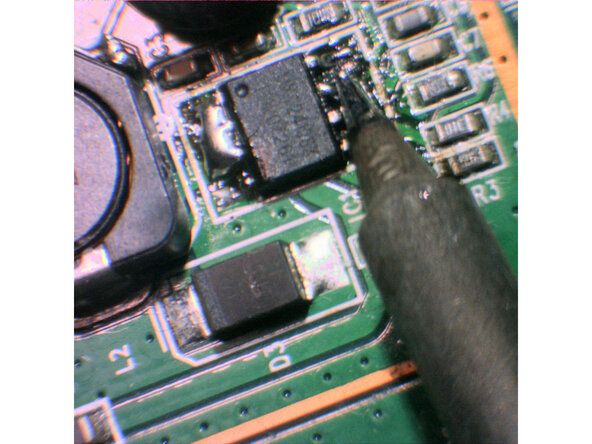

  10. Philips Wake-Up HF3520 Power supply repair, Soldering SO-8 IC: crwdns2935265:011crwdnd2935265:01crwdnd2935265:02crwdne2935265:0 Philips Wake-Up HF3520 Power supply repair, Soldering SO-8 IC: crwdns2935265:011crwdnd2935265:02crwdnd2935265:02crwdne2935265:0
    • Attach new IC (correct orientation, here dot to left where '220' coil is. Then use some flux and solder to attach the remaining pins.
