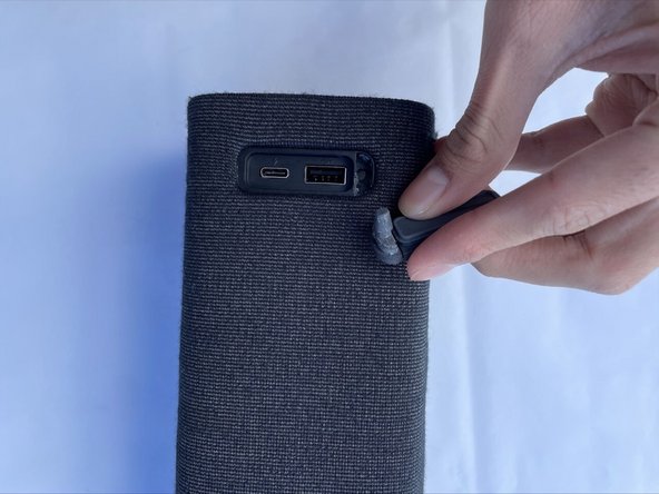

    • Make sure the speaker is turned off before you begin the disassembly.
    • Turn the speaker upside down. You will see a rubber base. Use an opening tool to lift up the sides to expose the screws.

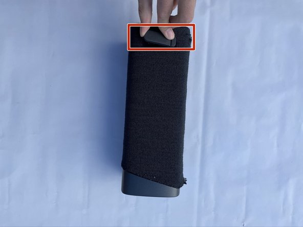

    • You can now see the inside of the speaker but you aren't done yet.
    • Remove both rubber stands that hold up the device horizontally (one of these stands is a cover for the USB ports).
  5. Philips TAS7505 USB-A & USB-C port Replacement: crwdns2935265:05crwdnd2935265:01crwdnd2935265:01crwdne2935265:0
    • Once you pull these out, you can pull the whole sleeve to expose the infrastructure of the device.
