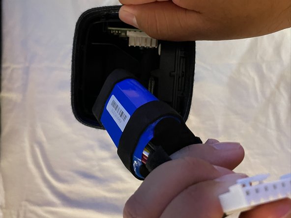

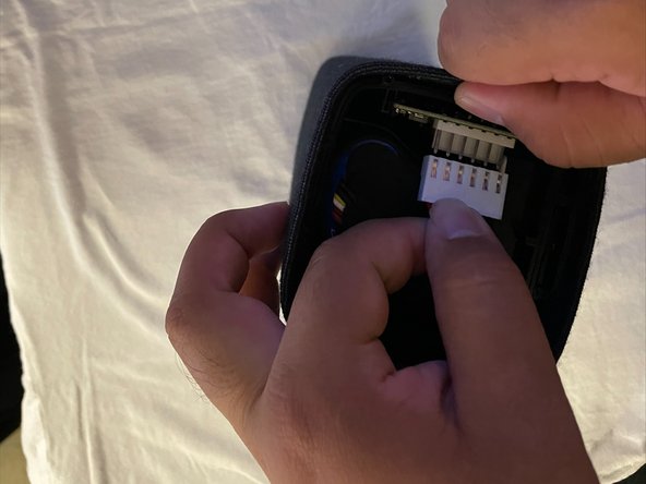

    • Squeeze the white connector on the bottom to release a clip that is hidden from sight. This will allow it to be wiggled free.
    • Remove the battery from the speaker by disconnecting the white connector from the motherboard.

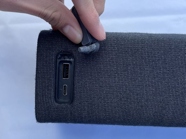

    • Find the rubber flap that covers the USB-A and USB-C port
    • Pull on the rubber flap, it should come out whole as shown in the second image

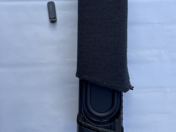

    • Once taken out the rubber flap, pull the interior of the speaker
  6. Philips TAS7505 Speaker Replacement: crwdns2935265:06crwdnd2935265:01crwdnd2935265:02crwdne2935265:0 Philips TAS7505 Speaker Replacement: crwdns2935265:06crwdnd2935265:02crwdnd2935265:02crwdne2935265:0
    • Once you have the speaker body out, unscrew the four screws holding the speaker down
    • Use Philips screwdriver head #0

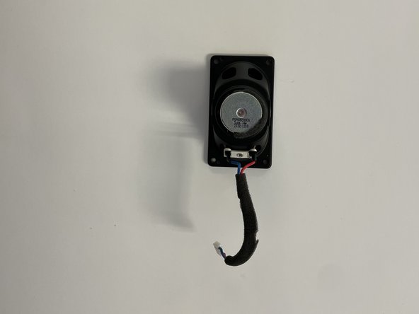

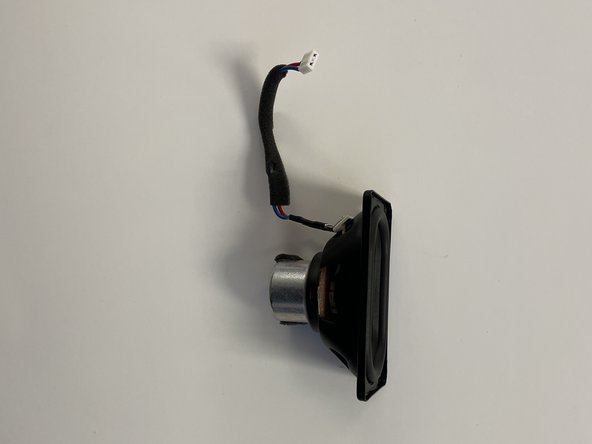

  8. Philips TAS7505 Speaker Replacement: crwdns2935265:08crwdnd2935265:01crwdnd2935265:03crwdne2935265:0 Philips TAS7505 Speaker Replacement: crwdns2935265:08crwdnd2935265:02crwdnd2935265:03crwdne2935265:0 Philips TAS7505 Speaker Replacement: crwdns2935265:08crwdnd2935265:03crwdnd2935265:03crwdne2935265:0
    • The speaker will look like this if you have followed the steps correctly
