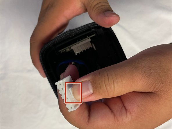

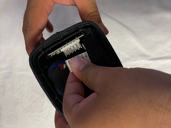

      • Disconnect the battery from the motherboard by unclipping it from the side not visible to you
      • If you are having difficulties disconnecting the battery you can pull the battery out whole in order to get a better angle to disconnect it

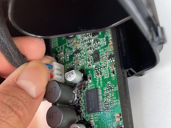

      • Next is to disconnect the speaker
      • pull the motherboard out as much as you can and then wiggle the white box back and forth to get it out

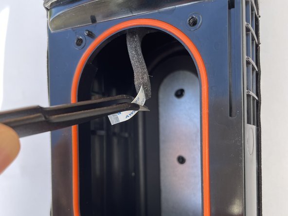

    4. Philips TAS7505 Motherboard Replacement: crwdns2935265:09crwdnd2935265:01crwdnd2935265:02crwdne2935265:0 Philips TAS7505 Motherboard Replacement: crwdns2935265:09crwdnd2935265:02crwdnd2935265:02crwdne2935265:0
      • Simply remove this white strand with a pair of tweezers.

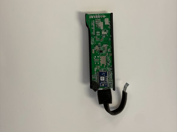

    5. Philips TAS7505 Motherboard Replacement: crwdns2935265:010crwdnd2935265:01crwdnd2935265:02crwdne2935265:0 Philips TAS7505 Motherboard Replacement: crwdns2935265:010crwdnd2935265:02crwdnd2935265:02crwdne2935265:0
      • This is how the motherboard should be after doing all the steps correctly.
