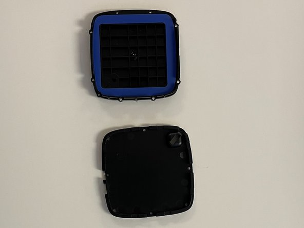

    2. Philips TAS7505 Battery Replacement: crwdns2935265:02crwdnd2935265:01crwdnd2935265:03crwdne2935265:0 Philips TAS7505 Battery Replacement: crwdns2935265:02crwdnd2935265:02crwdnd2935265:03crwdne2935265:0 Philips TAS7505 Battery Replacement: crwdns2935265:02crwdnd2935265:03crwdnd2935265:03crwdne2935265:0
      • Remove the four Phillips #0 screws attached to the cover and remove with the opening tool.
    3. Philips TAS7505 Battery Replacement: crwdns2935265:03crwdnd2935265:01crwdnd2935265:02crwdne2935265:0 Philips TAS7505 Battery Replacement: crwdns2935265:03crwdnd2935265:02crwdnd2935265:02crwdne2935265:0
      • Remove all Phillips #0 screws to remove the final layers to open the inside.

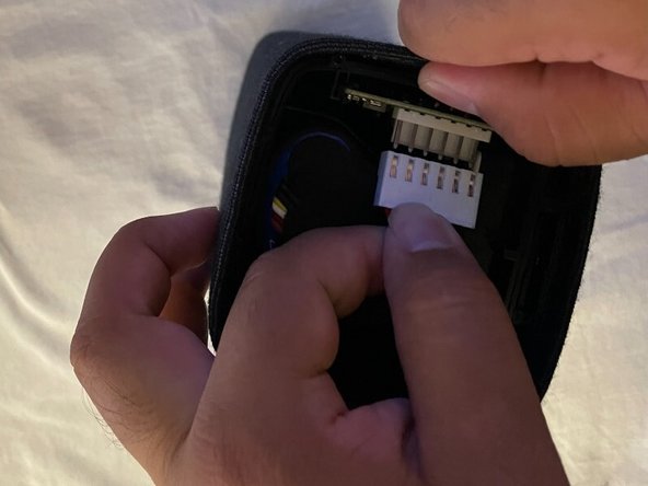

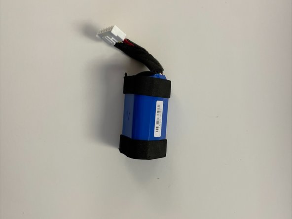

    4. Philips TAS7505 Battery Replacement: crwdns2935265:04crwdnd2935265:01crwdnd2935265:02crwdne2935265:0 Philips TAS7505 Battery Replacement: crwdns2935265:04crwdnd2935265:02crwdnd2935265:02crwdne2935265:0
      • Remove the battery from the motherboard.
      • The cable that connects the battery to the speaker is attached to small pins. You can use your hands to wiggle the battery out.
    5. Philips TAS7505 Battery Replacement: crwdns2935265:05crwdnd2935265:01crwdnd2935265:02crwdne2935265:0 Philips TAS7505 Battery Replacement: crwdns2935265:05crwdnd2935265:02crwdnd2935265:02crwdne2935265:0
      • After removing the battery, insert the replacement battery.
