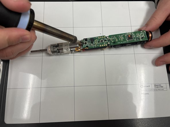

    • Locate the power button (solder locations circled in orange).
    • Locate the mode button (solder locations circled in red).
    • Both buttons are attached by four soldered pins each.
  5. Philips Sonicare ProtectiveClean 6500 Power Button, Mode Button Replacement: crwdns2935265:05crwdnd2935265:01crwdnd2935265:02crwdne2935265:0 Philips Sonicare ProtectiveClean 6500 Power Button, Mode Button Replacement: crwdns2935265:05crwdnd2935265:02crwdnd2935265:02crwdne2935265:0
    • Heat the soldering iron.
    • Soldering can cause burns and fires. Always solder in a well-ventilated area.
    • To test if the soldering iron is ready, place on the solder and if the solder melts easily and quickly, your soldering iron is ready.
    • Use the soldering iron to desolder all of the connections.
  6. Philips Sonicare ProtectiveClean 6500 Power Button, Mode Button Replacement: crwdns2935265:06crwdnd2935265:01crwdnd2935265:02crwdne2935265:0 Philips Sonicare ProtectiveClean 6500 Power Button, Mode Button Replacement: crwdns2935265:06crwdnd2935265:02crwdnd2935265:02crwdne2935265:0
    • Use tweezers to remove the buttons from the board.
    • Place new button onto board and repeat previous steps in reverse to reassemble.
