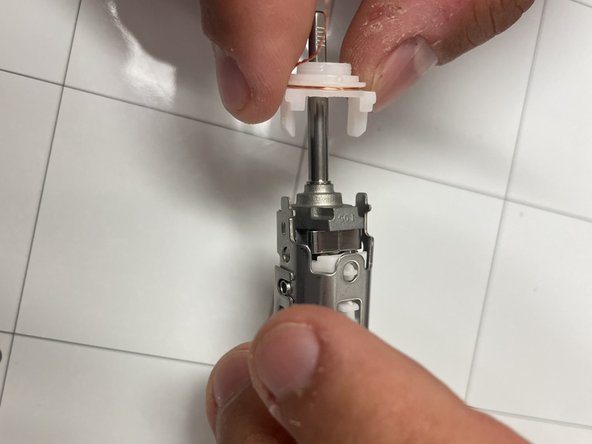

  9. Philips Sonicare ProtectiveClean 6500 Motor Replacement: crwdns2935265:09crwdnd2935265:01crwdnd2935265:02crwdne2935265:0 Philips Sonicare ProtectiveClean 6500 Motor Replacement: crwdns2935265:09crwdnd2935265:02crwdnd2935265:02crwdne2935265:0
    • Use a pointed tool to push in the tabs on either side of the white assembly .
    • Pull the wire carrier off of motor chassis.
    • Swap it to the new motor chassis.
