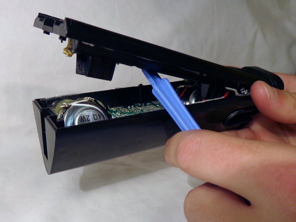

    • Remove the colored grill by sliding it off in the direction of the removed end piece.
    • Pry off the back battery panel with the plastic opening tool.
    • Be careful to avoid tearing any wires.

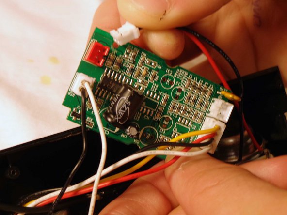

    • Remove the circuit board by unscrewing the two interior screws located on the circuit board.
    • Pull out the battery plugs from the circuit board by pulling out the plugs to fully remove the back panel from the rest of the speaker.

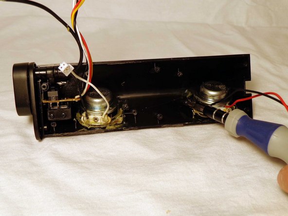

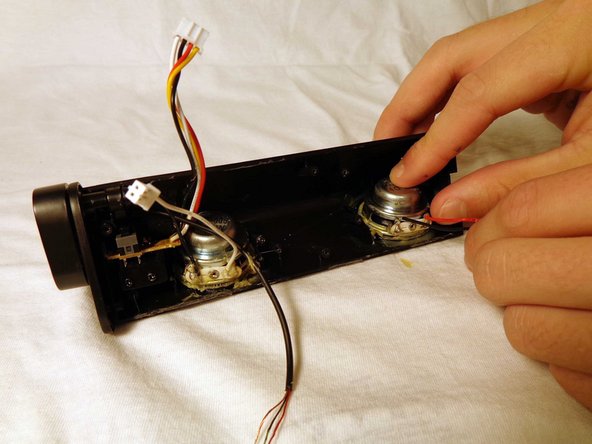

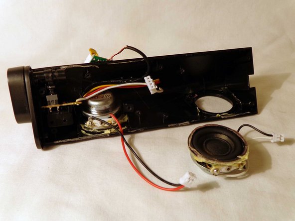

    • Locate the speaker needing replacing.
    • Remove the one screw holding the speaker in place with a PH0 size philips head screw driver.

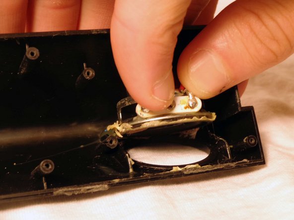

  6. Philips SBA1060 Speaker Replacement: crwdns2935265:06crwdnd2935265:01crwdnd2935265:03crwdne2935265:0 Philips SBA1060 Speaker Replacement: crwdns2935265:06crwdnd2935265:02crwdnd2935265:03crwdne2935265:0 Philips SBA1060 Speaker Replacement: crwdns2935265:06crwdnd2935265:03crwdnd2935265:03crwdne2935265:0
    • Score the glue that is holding the speaker in place with the spudger, and use your hands to pry off the speaker.
  7. Philips SBA1060 Speaker Replacement: crwdns2935265:07crwdnd2935265:01crwdnd2935265:02crwdne2935265:0 Philips SBA1060 Speaker Replacement: crwdns2935265:07crwdnd2935265:02crwdnd2935265:02crwdne2935265:0
    • Using a non-conductive glue, carefully seal the speaker to the casing.
    • Follow the glue instructions as set by the manufacturers. Let the glue set the appropriate amount of time.
    • Reassemble the device
