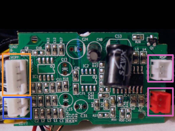

  4. Philips SBA1060 Circuit Board Replacement, Circuit Board: crwdns2935265:04crwdnd2935265:01crwdnd2935265:01crwdne2935265:0
    • Remove the two screws on opposite ends of the circuit board with the PH0 size philips head screw driver.
    • Remove the damaged circuit board from the device.
  5. Philips SBA1060 Circuit Board Replacement: crwdns2935265:05crwdnd2935265:01crwdnd2935265:02crwdne2935265:0 Philips SBA1060 Circuit Board Replacement: crwdns2935265:05crwdnd2935265:02crwdnd2935265:02crwdne2935265:0
    • Remove the battery plug from the circuit board by pulling out the plugs to fully remove back panel.
    • Remove the speaker plugs from the circuit board by pulling out the plugs. They are located on opposite sides of the circuit board.
    • NOTE: When reassembling, note that the speaker with the red wire goes to the red plug, and the speaker with the white wire goes to the adjacent white plug.
    • Remove the light plug from the circuit board.
    • NOTE: This plug is twice as wide as the speaker and battery plugs.
    • Reassemble the device.

Is that one of those cheap pam amps that run from 5v?
fabio souza jr - crwdns2934203:0crwdne2934203:0
Nice picture,it helps a lot in trouble shooting !
sergio - crwdns2934203:0crwdne2934203:0
