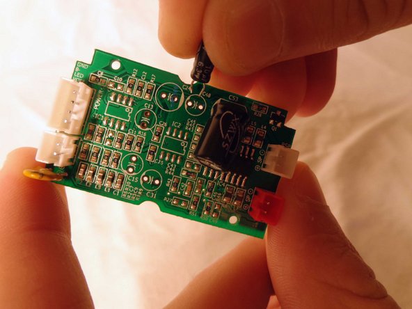

    1. Philips SBA1060 Capacitor Replacement, Capacitor: crwdns2935265:04crwdnd2935265:01crwdnd2935265:01crwdne2935265:0
      • Remove the two screws on opposite ends of the circuit board with the PH0 size philips head screw driver.
      • Slowly pull the circuit board out of the device
      • NOTE: Be careful not to damage any of the wires protruding from the back of the circuit board.

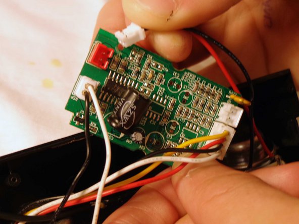

    2. Philips SBA1060 Capacitor Replacement: crwdns2935265:05crwdnd2935265:01crwdnd2935265:02crwdne2935265:0 Philips SBA1060 Capacitor Replacement: crwdns2935265:05crwdnd2935265:02crwdnd2935265:02crwdne2935265:0
      • Flip the device and remove the battery plug from the circuit board by pulling out the plugs to fully remove back panel.
      • Remove the speaker plugs from the circuit board by pulling out the plugs. They are located on opposite sides of the circuit board.
      • NOTE: When reassembling, note that the speaker with the red wire goes to the red plug, and the speaker with the white wire goes to the adjacent white plug.
      • Remove the light plug from the circuit board.
      • NOTE: This plug is twice as wide as the speaker and battery plugs.
    3. Philips SBA1060 Capacitor Replacement: crwdns2935265:06crwdnd2935265:01crwdnd2935265:02crwdne2935265:0 Philips SBA1060 Capacitor Replacement: crwdns2935265:06crwdnd2935265:02crwdnd2935265:02crwdne2935265:0
      • Locate the capacitor and carefully slide it out of the circuit board.
      • NOTE: The capacitor will be a cylindrical object protruding vertically near the center of the circuit board.
      • Slide the prongs of the replacement capacitor into the two holes of the circuit board where the original capacitor was removed from.
      • Reassemble the speaker.
