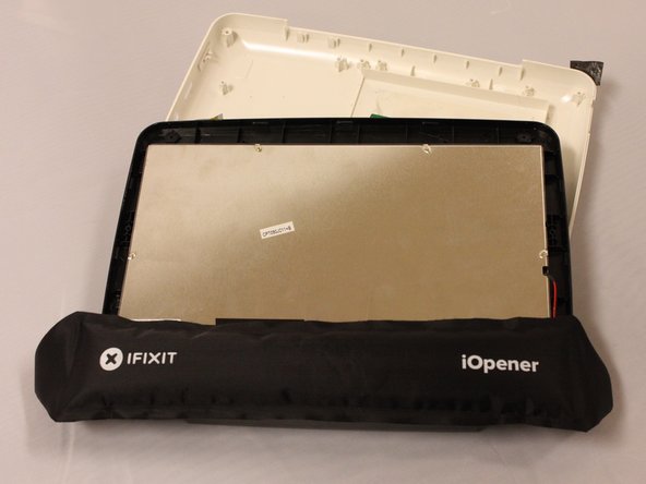

  5. Philips PD9000 37 Internal Speakers Replacement, Internal Speakers: crwdns2935265:05crwdnd2935265:01crwdnd2935265:01crwdne2935265:0
    • Desolder the wires connected to the round speakers.
  6. Philips PD9000 37 Internal Speakers Replacement: crwdns2935265:06crwdnd2935265:01crwdnd2935265:02crwdne2935265:0 Philips PD9000 37 Internal Speakers Replacement: crwdns2935265:06crwdnd2935265:02crwdnd2935265:02crwdne2935265:0
    • Place the iOpener over the entire speaker panel to warm the glue.
  7. Philips PD9000 37 Internal Speakers Replacement: crwdns2935265:07crwdnd2935265:01crwdnd2935265:01crwdne2935265:0
    • After the glue is softened, use the metal spudger to scrape the glue away.
    • You may need to use the iOpener more than once per speaker, but be sure to follow the instructions for the iOpener so as not to overheat it.
  8. Philips PD9000 37 Internal Speakers Replacement: crwdns2935265:08crwdnd2935265:01crwdnd2935265:01crwdne2935265:0
    • Use the spudger to pry the speaker out of it's setting.
