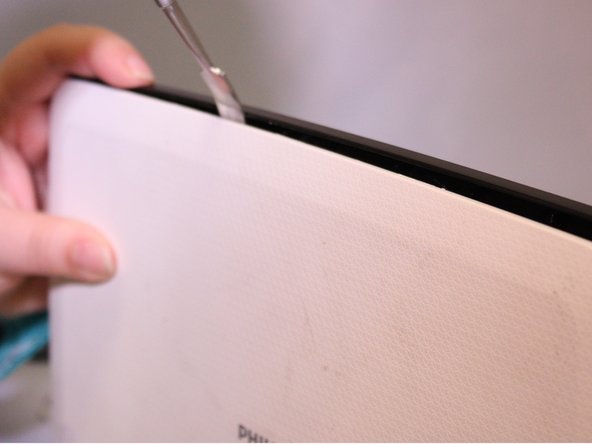

    3. Philips PD9000 37 Disk Drive Replacement: crwdns2935265:03crwdnd2935265:01crwdnd2935265:03crwdne2935265:0 Philips PD9000 37 Disk Drive Replacement: crwdns2935265:03crwdnd2935265:02crwdnd2935265:03crwdne2935265:0 Philips PD9000 37 Disk Drive Replacement: crwdns2935265:03crwdnd2935265:03crwdnd2935265:03crwdne2935265:0
      • Start removing the inside black face plate of the player by using a prying method between the white outer housing and the black face plate with a metal spudger.
      • Pull the black face plate off once you have pried it from the white housing. The bottom inside layer should pop off.
      • Using the same prying method with the metal spudger, start prying off the screens white outer housing.

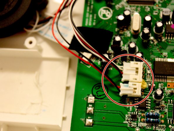

    1. Philips PD9000 37 Disk Drive Replacement, Disk Drive: crwdns2935265:05crwdnd2935265:01crwdnd2935265:02crwdne2935265:0 Philips PD9000 37 Disk Drive Replacement, Disk Drive: crwdns2935265:05crwdnd2935265:02crwdnd2935265:02crwdne2935265:0
      • Using the Tweezers from the iFixit repair tools, pull the two white plastic connectors that connect the disk drive to the motherboard off detaching the disk drive from the motherboard.
    2. Philips PD9000 37 Disk Drive Replacement: crwdns2935265:06crwdnd2935265:01crwdnd2935265:01crwdne2935265:0
      • Grab the sides of the disk drive and gently pull straight up to detach the disk drive.
      • The white ribbon is not connected to the actual drive, so it can be ignored.
