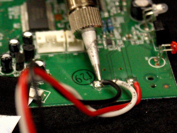

    • Use a soldering iron to melt the metal connecting the battery wires to the mother board.
    • Quickly remove each wire after melting the metal
    • Soldering iron is HOT and will burn you.
    • Wires will get HOT and may burn you.
