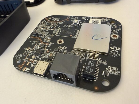

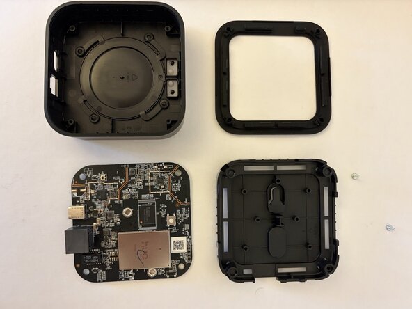

    • 1. Pry off the bottom rubber with your fingernail (no sharp tools).
    • 2. Remove the two screws in the corners.
    • 3. Lift off the bottom plate.
    • 4. Gently flip the main board upward to access it. Safe and simple.
