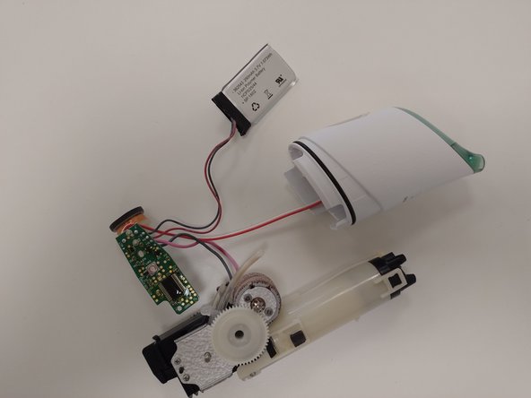

  2. Philips HX8210/22 Sonicare Airfloss Microjet Teardown, Extract components from case: crwdns2935265:02crwdnd2935265:01crwdnd2935265:03crwdne2935265:0 Philips HX8210/22 Sonicare Airfloss Microjet Teardown, Extract components from case: crwdns2935265:02crwdnd2935265:02crwdnd2935265:03crwdne2935265:0 Philips HX8210/22 Sonicare Airfloss Microjet Teardown, Extract components from case: crwdns2935265:02crwdnd2935265:03crwdnd2935265:03crwdne2935265:0
    • Gently unplug the main board from the mechanical parts, pulling it up from the bottom (it is not glued)
    • Remove the tape holding the cables
    • Unplug the water cable
    • You can now pull out all the components, you willl have only four cables going to the upper part (for the battery and the trigger button)

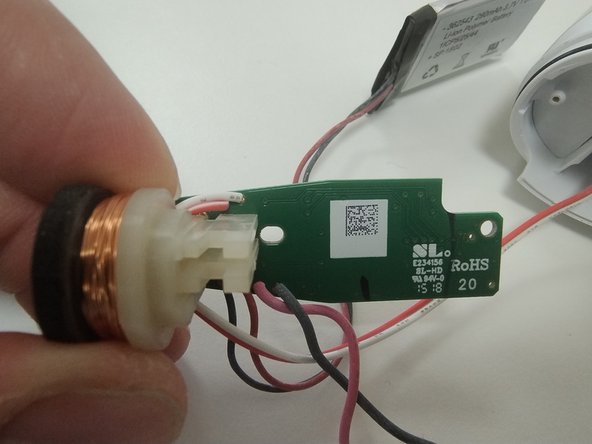

  3. Philips HX8210/22 Sonicare Airfloss Microjet Teardown, Inspect main board: crwdns2935265:03crwdnd2935265:01crwdnd2935265:02crwdne2935265:0 Philips HX8210/22 Sonicare Airfloss Microjet Teardown, Inspect main board: crwdns2935265:03crwdnd2935265:02crwdnd2935265:02crwdne2935265:0
    • Inspect the main board

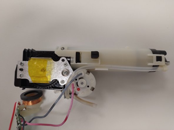

  4. Philips HX8210/22 Sonicare Airfloss Microjet Teardown, Inspect mechanical parts: crwdns2935265:04crwdnd2935265:01crwdnd2935265:02crwdne2935265:0 Philips HX8210/22 Sonicare Airfloss Microjet Teardown, Inspect mechanical parts: crwdns2935265:04crwdnd2935265:02crwdnd2935265:02crwdne2935265:0
    • Inspect mechanical parts

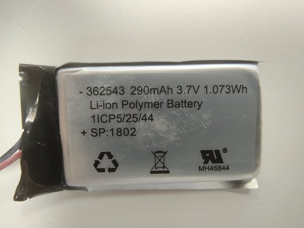

  5. Philips HX8210/22 Sonicare Airfloss Microjet Teardown, Remove battery: crwdns2935265:05crwdnd2935265:01crwdnd2935265:03crwdne2935265:0 Philips HX8210/22 Sonicare Airfloss Microjet Teardown, Remove battery: crwdns2935265:05crwdnd2935265:02crwdnd2935265:03crwdne2935265:0 Philips HX8210/22 Sonicare Airfloss Microjet Teardown, Remove battery: crwdns2935265:05crwdnd2935265:03crwdnd2935265:03crwdne2935265:0
    • The battery is glued to the upper part, you can remove it by gently pulling it from the case with a flat screwdrier
