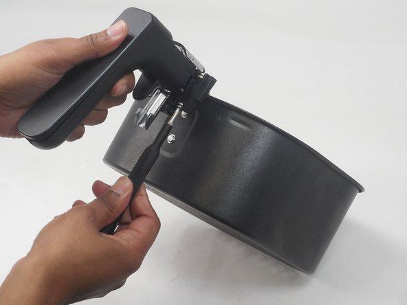

      • Remove the tray from the air fryer by pressing the latch button in, and pulling the handle away.
    2. Philips HD9252 Latch Button Replacement: crwdns2935265:02crwdnd2935265:01crwdnd2935265:01crwdne2935265:0
      • Pull the tray out of the basket.

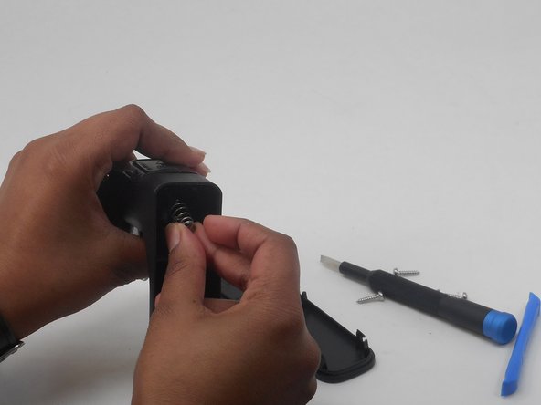

      • Pry off the back panel of the handle.
    4. Philips HD9252 Latch Button Replacement: crwdns2935265:06crwdnd2935265:01crwdnd2935265:02crwdne2935265:0 Philips HD9252 Latch Button Replacement: crwdns2935265:06crwdnd2935265:02crwdnd2935265:02crwdne2935265:0
      • Push the spring down with a nylon spudger so that it is underneath the button.
      • Slide the spring out of the back of the handle.
