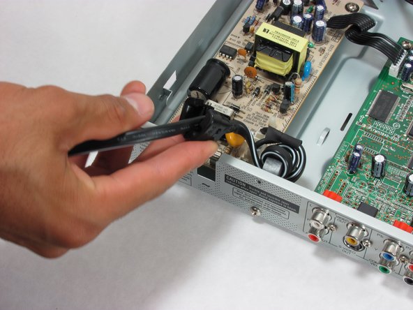

  3. Philips DVP642 Power Supply Replacement, Power Supply: crwdns2935265:03crwdnd2935265:01crwdnd2935265:02crwdne2935265:0 Philips DVP642 Power Supply Replacement, Power Supply: crwdns2935265:03crwdnd2935265:02crwdnd2935265:02crwdne2935265:0
    • Slide the power cord out from the case.
    • Be sure not to lose the rubber clip that is wrapped around the cord.
