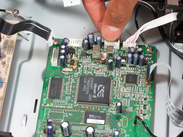

  3. Philips DVP642 Motherboard Replacement, Motherboard: crwdns2935265:03crwdnd2935265:01crwdnd2935265:03crwdne2935265:0 Philips DVP642 Motherboard Replacement, Motherboard: crwdns2935265:03crwdnd2935265:02crwdnd2935265:03crwdne2935265:0 Philips DVP642 Motherboard Replacement, Motherboard: crwdns2935265:03crwdnd2935265:03crwdnd2935265:03crwdne2935265:0
    • Locate the first three ribbon wires.
    • Remove the ribbon wires by grasping firmly as near to the plastic head as possible and pulling.
    • Be firm, but gentle when pulling to avoid pulling the wires off the head.

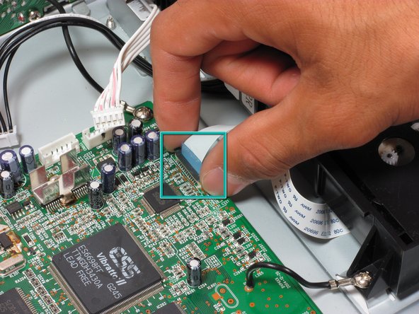

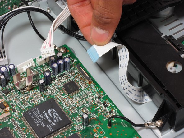

  4. Philips DVP642 Motherboard Replacement: crwdns2935265:04crwdnd2935265:01crwdnd2935265:03crwdne2935265:0 Philips DVP642 Motherboard Replacement: crwdns2935265:04crwdnd2935265:02crwdnd2935265:03crwdne2935265:0 Philips DVP642 Motherboard Replacement: crwdns2935265:04crwdnd2935265:03crwdnd2935265:03crwdne2935265:0
    • Remove the fourth ribbon wire as in step 2.
    • Remove the fifth ribbon wire by grasping both sides of the black clip and pulling up. When reinserting, pull black clip up, insert the ribbon wire, and push the black clip back down.

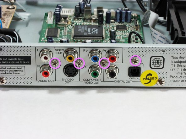

  5. Philips DVP642 Motherboard Replacement: crwdns2935265:05crwdnd2935265:01crwdnd2935265:02crwdne2935265:0 Philips DVP642 Motherboard Replacement: crwdns2935265:05crwdnd2935265:02crwdnd2935265:02crwdne2935265:0
    • Remove the following screws:
    • 7.5 mm Phillips screws (2) that secure the motherboard to the bottom panel. The screw on the top right will also be attached to a grounding wire, it is okay to remove this screw.
    • Remove the 7.5 mm Phillips screw on the bottom right that attaches the grounding wire to the disc tray.
    • 7.5 mm Phillips screws (4) on outside of player near input/output plugs.
  6. Philips DVP642 Motherboard Replacement: crwdns2935265:06crwdnd2935265:01crwdnd2935265:01crwdne2935265:0
    • Remove the motherboard by pulling it back and then up gently.
    • The input/output plugs should slide out easily from the holes in the back panel.
