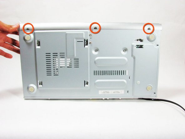

      • Remove three 7.5mm screws from the bottom of the player.
      • Note that the three screws from the bottom are slightly different screws.

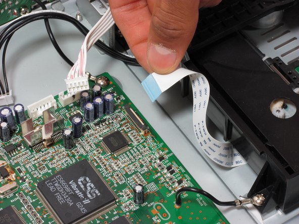

      • Detach all the ribbon wires (4) attached to the motherboard
    3. Philips DVP642 Disc Tray Replacement: crwdns2935265:05crwdnd2935265:01crwdnd2935265:03crwdne2935265:0 Philips DVP642 Disc Tray Replacement: crwdns2935265:05crwdnd2935265:02crwdnd2935265:03crwdne2935265:0 Philips DVP642 Disc Tray Replacement: crwdns2935265:05crwdnd2935265:03crwdnd2935265:03crwdne2935265:0
      • The first 3 ribbon wires can be removed by grasping near the head and gently pulling up.

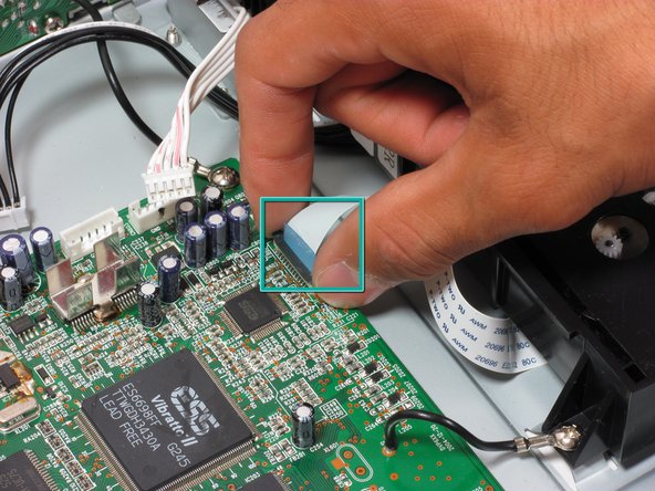

      • Locate the skinny fourth ribbon wire near the top right of the motherboard.
      • Remove the fourth ribbon wire by grasping both sides of the black clip and pulling up. When reinserting, pull the black clip up, insert the ribbon ribbon, and push the black clip back down.
      • Be firm, but gentle when pulling to avoid pulling the wires off the head.
