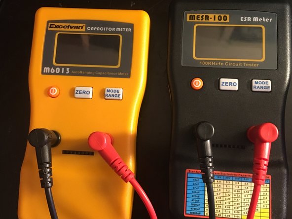

  9. Philips DVP642 Capacitor (C316) Replacement, Inspect The Capacitor: crwdns2935265:09crwdnd2935265:01crwdnd2935265:02crwdne2935265:0 Philips DVP642 Capacitor (C316) Replacement, Inspect The Capacitor: crwdns2935265:09crwdnd2935265:02crwdnd2935265:02crwdne2935265:0
    • If the top of the capacitor is bulging (or completely blown out) this is an indication that the capacitor has failed.
    • If the capacitor is not bulging, it could still be bad. You can test this using a capacitance meter or an ESR meter.

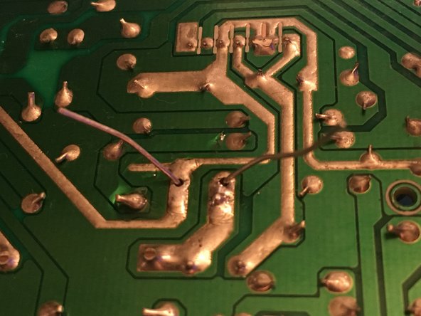

  10. Philips DVP642 Capacitor (C316) Replacement, Desolder The Capacitor: crwdns2935265:010crwdnd2935265:01crwdnd2935265:01crwdne2935265:0
    • The two joints indicated in the picture are the ones you need to desolder.
    • Add a little bit of flux to the solder joints and tin the tip of your soldering iron.
    • When the solder melts, use the desoldering tool to remove the solder.
    • Remove the old capacitor

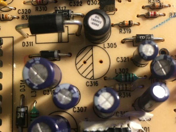

  11. Philips DVP642 Capacitor (C316) Replacement, Solder The New Capacitor: crwdns2935265:011crwdnd2935265:01crwdnd2935265:03crwdne2935265:0 Philips DVP642 Capacitor (C316) Replacement, Solder The New Capacitor: crwdns2935265:011crwdnd2935265:02crwdnd2935265:03crwdne2935265:0 Philips DVP642 Capacitor (C316) Replacement, Solder The New Capacitor: crwdns2935265:011crwdnd2935265:03crwdnd2935265:03crwdne2935265:0
    • Be conscious of the orientation of the new capacitor. Electrolytic capacitors like this one are polarized and will only work in one direction.
    • Notice that I am using a capacitor with the same capacitance, but a higher voltage rating. This only increases the voltage the capacitor can handle before failing, it does not raise the voltage of the circuit. It is important not to use a lower value, however. Be sure to use the correct capacitance (1000uF).
    • The grey line indicates which side is negative. The negative side also typically has a shorter lead. On the board, the "shaded" half of the circle with the hashmarks is the negative side.
    • Insert the new capacitor and bend the legs outward to help hold it in place when you turn the board over.
    • Solder the leads and clip the excess length.
