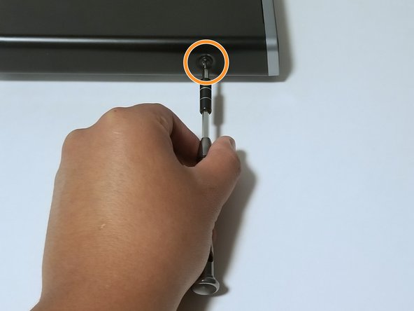

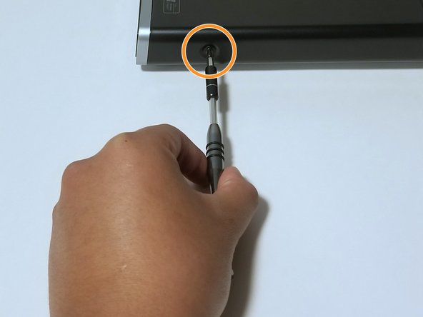

    • Remove the three 6.4 mm Phillips #1 screws on the back of the device with a Phillips head screwdriver.
    • Remove the 6.4 mm Phillips #1 screws on each side of the device.

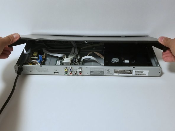

    • Remove the top plate of the DVD by firmly grasping the player on both sides.
    • Shift the top plate towards the backside of the player.
    • Lift the back half of the top plate up to remove it from the player.

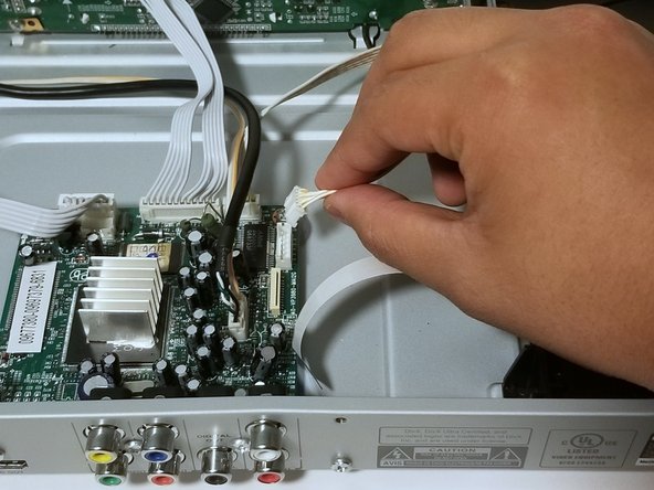

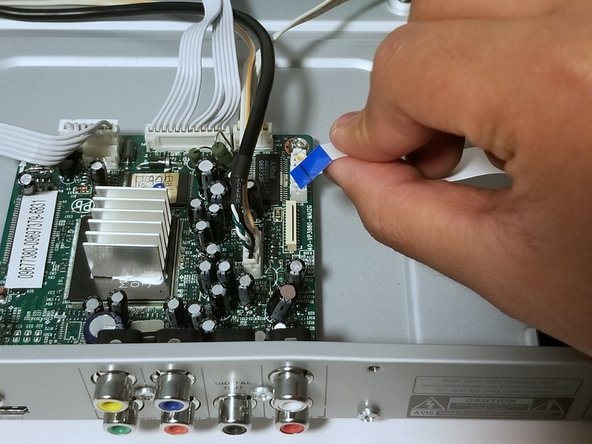

    • Locate the motherboard within the DVD player.
    • Firmly grasp the ribbon wire and unplug it from the motherboard.

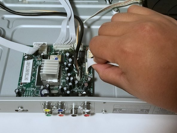

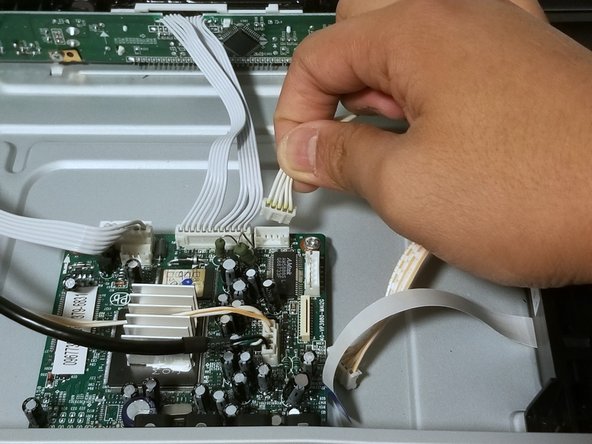

    • Firmly grasp the bundled cable connector that attaches the tray to the motherboard.
    • Gently pull upwards to remove the bundled cable connector from the motherboard.
  7. Philips DVP5992-F7 Tray Replacement: crwdns2935265:07crwdnd2935265:01crwdnd2935265:02crwdne2935265:0 Philips DVP5992-F7 Tray Replacement: crwdns2935265:07crwdnd2935265:02crwdnd2935265:02crwdne2935265:0
    • Firmly grasp the second bundled cable connector that attaches the tray to the motherboard.
    • Gently pull upwards to remove the second bundled cable connector from the motherboard.

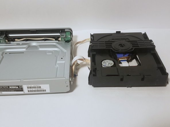

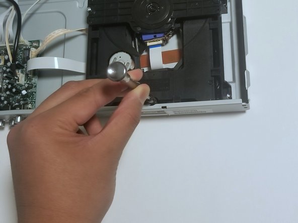

    • Remove the 9.0 mm #1 Phillips head screw that holds the tray to the DVD player.
  9. Philips DVP5992-F7 Tray Replacement: crwdns2935265:09crwdnd2935265:01crwdnd2935265:02crwdne2935265:0 Philips DVP5992-F7 Tray Replacement: crwdns2935265:09crwdnd2935265:02crwdnd2935265:02crwdne2935265:0
    • Lift the tray out of the DVD player from the back.
