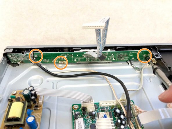

    3. Philips DVP5992-F7 Screen Replacement: crwdns2935265:03crwdnd2935265:01crwdnd2935265:03crwdne2935265:0 Philips DVP5992-F7 Screen Replacement: crwdns2935265:03crwdnd2935265:02crwdnd2935265:03crwdne2935265:0 Philips DVP5992-F7 Screen Replacement: crwdns2935265:03crwdnd2935265:03crwdnd2935265:03crwdne2935265:0

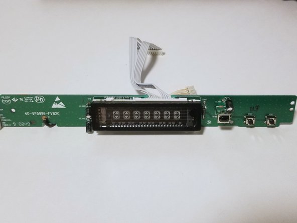

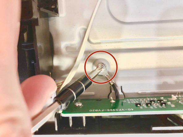

      • Unplug the bundled cable connector that attaches the screen to the motherboard.
      • Remove the 3.175 mm Phillips #1 screw that connects the screen's ground wire to the shell of the DVD player.
      • Remove the three 6.35 mm Phillips #1 screws that attach the screen to the front cover of the DVD player.
    4. Philips DVP5992-F7 Screen Replacement: crwdns2935265:04crwdnd2935265:01crwdnd2935265:02crwdne2935265:0 Philips DVP5992-F7 Screen Replacement: crwdns2935265:04crwdnd2935265:02crwdnd2935265:02crwdne2935265:0
      • Slowly pull the screen backwards starting with the side farthest from the disc tray.
      • Unplug the bundled cable connector that is located close to the disc tray as you pull the screen out of the DVD player.
