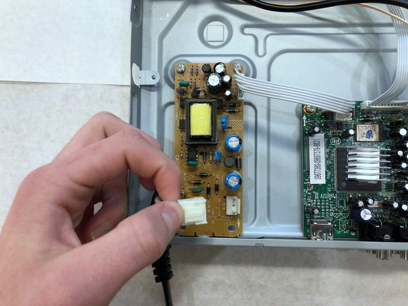

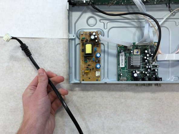

  3. Philips DVP5992-F7 Power Cord Replacement: crwdns2935265:03crwdnd2935265:01crwdnd2935265:03crwdne2935265:0 Philips DVP5992-F7 Power Cord Replacement: crwdns2935265:03crwdnd2935265:02crwdnd2935265:03crwdne2935265:0 Philips DVP5992-F7 Power Cord Replacement: crwdns2935265:03crwdnd2935265:03crwdnd2935265:03crwdne2935265:0
    • Locate the power cable connector inside the DVD player.
    • Pinch down on both sides of the cable connector.
    • Gently pull upwards on the cable connector while wiggling it to remove it from the DVD player.
