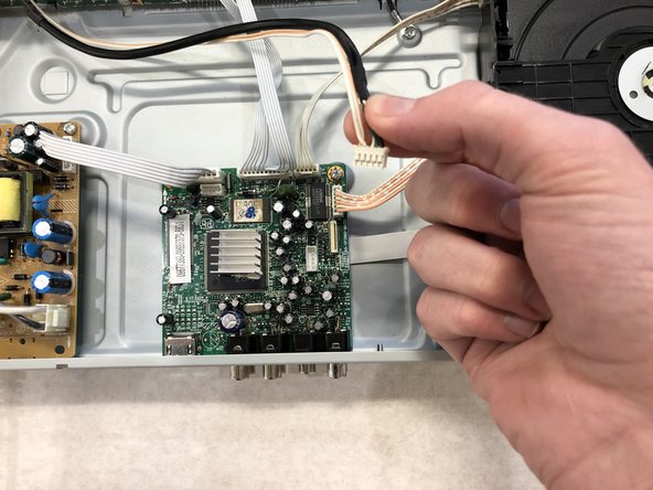

    • Unplug the one ribbon wire and the five bundled cable connectors that are plugged into the motherboard.

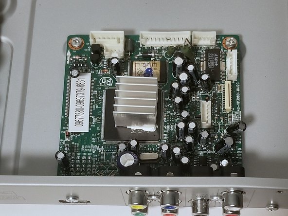

    • Remove the three 4.76 mm #1 Phillips head screws located on the back of the DVD player.
  5. Philips DVP5992-F7 HDMI port Replacement: crwdns2935265:05crwdnd2935265:01crwdnd2935265:01crwdne2935265:0
    • Remove the two 7.94 mm #1 Phillips head screws from the motherboard.
  6. Philips DVP5992-F7 HDMI port Replacement: crwdns2935265:06crwdnd2935265:01crwdnd2935265:01crwdne2935265:0
    • Remove the motherboard from the DVD player.
