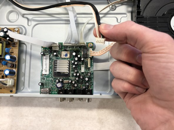

    • Remove the three 6.4 mm Phillips #1 screws on the back of the device with a Phillips head screwdriver.
    • Remove the 6.4 mm Phillips #1 screws on each side of the device.
  2. Philips DVP5992-F7 Audio Video Port Replacement: crwdns2935265:02crwdnd2935265:01crwdnd2935265:02crwdne2935265:0 Philips DVP5992-F7 Audio Video Port Replacement: crwdns2935265:02crwdnd2935265:02crwdnd2935265:02crwdne2935265:0
    • Remove the top plate of the DVD by firmly grasping the player on both sides.
    • Shift the top plate towards the backside of the player.
    • Lift the back half of the top plate up to remove it from the player.
  3. Philips DVP5992-F7 Audio Video Port Replacement: crwdns2935265:03crwdnd2935265:01crwdnd2935265:03crwdne2935265:0 Philips DVP5992-F7 Audio Video Port Replacement: crwdns2935265:03crwdnd2935265:02crwdnd2935265:03crwdne2935265:0 Philips DVP5992-F7 Audio Video Port Replacement: crwdns2935265:03crwdnd2935265:03crwdnd2935265:03crwdne2935265:0
    • Unplug the one ribbon wire and the five bundled cable connectors that are plugged into the motherboard.

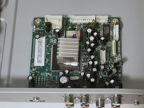

  4. Philips DVP5992-F7 Audio Video Port Replacement: crwdns2935265:04crwdnd2935265:01crwdnd2935265:01crwdne2935265:0
    • Remove the three 4.76 mm #1 Phillips head screws located on the back of the DVD player.
  5. Philips DVP5992-F7 Audio Video Port Replacement: crwdns2935265:05crwdnd2935265:01crwdnd2935265:01crwdne2935265:0
    • Remove the two 7.94 mm #1 Phillips head screws from the motherboard.
  6. Philips DVP5992-F7 Audio Video Port Replacement: crwdns2935265:06crwdnd2935265:01crwdnd2935265:01crwdne2935265:0
    • Remove the motherboard from the DVD player.
