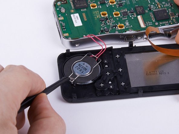

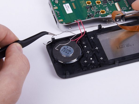

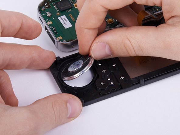

  9. Philips DPM8000 Speaker Replacement, Speaker: crwdns2935265:09crwdnd2935265:01crwdnd2935265:03crwdne2935265:0 Philips DPM8000 Speaker Replacement, Speaker: crwdns2935265:09crwdnd2935265:02crwdnd2935265:03crwdne2935265:0 Philips DPM8000 Speaker Replacement, Speaker: crwdns2935265:09crwdnd2935265:03crwdnd2935265:03crwdne2935265:0
    • Remove the mounting spring from the speaker with a pair of tweezers.
    • If you just want to replace the motherboard, it is recommended to ignore the steps 9 and 10.
  10. Philips DPM8000 Speaker Replacement: crwdns2935265:010crwdnd2935265:01crwdnd2935265:02crwdne2935265:0 Philips DPM8000 Speaker Replacement: crwdns2935265:010crwdnd2935265:02crwdnd2935265:02crwdne2935265:0
    • Take off the safety mat from the speaker.
    • Remove the speaker from the housing.

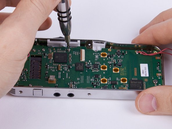

  11. Philips DPM8000 Speaker Replacement, Motherboard: crwdns2935265:011crwdnd2935265:01crwdnd2935265:02crwdne2935265:0 Philips DPM8000 Speaker Replacement, Motherboard: crwdns2935265:011crwdnd2935265:02crwdnd2935265:02crwdne2935265:0
    • Unscrew the eight Torx #4 (5,0 mm) screws from the motherboard.
    • These two screws connect the motherboard with the sliding cage. In this guide they are removed as well. Hence this is not compulsory you can decide for yourself whether you want to remove them now or later.

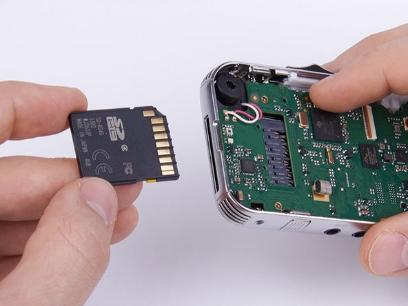

  12. Philips DPM8000 Speaker Replacement: crwdns2935265:012crwdnd2935265:01crwdnd2935265:02crwdne2935265:0 Philips DPM8000 Speaker Replacement: crwdns2935265:012crwdnd2935265:02crwdnd2935265:02crwdne2935265:0
    • Push in the SD-Card to eject it.
    • If the memory card remains in its slot you will not be able to remove the motherboard.

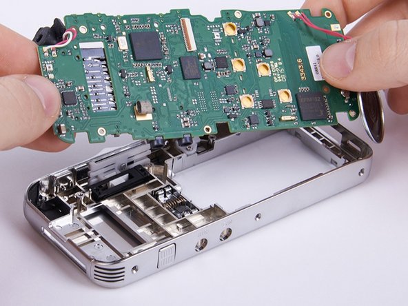

    • Abstract the motherboard.
    • Lift up the motherboard as shown in the picture before completely removing it.
    • When inserting the motherboard first put in the side with the speaker jack on it and make sure that the microphone is placed properly under the motherboard.

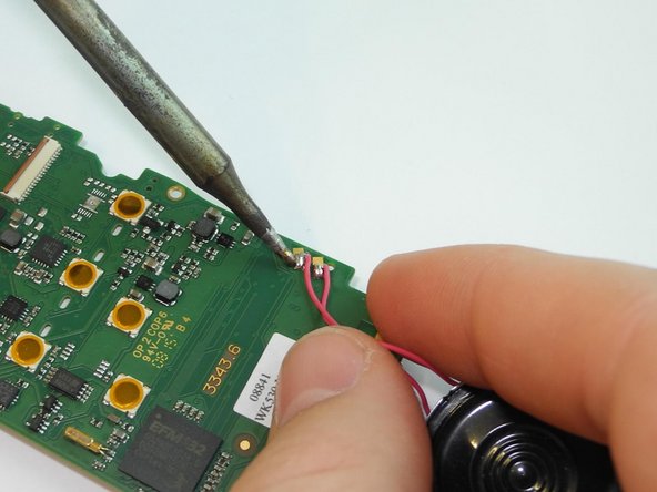

  14. Philips DPM8000 Speaker Replacement, Speaker: crwdns2935265:014crwdnd2935265:01crwdnd2935265:02crwdne2935265:0 Philips DPM8000 Speaker Replacement, Speaker: crwdns2935265:014crwdnd2935265:02crwdnd2935265:02crwdne2935265:0
    • Preheat your soldering equipment.
    • Dissolve the soldering connection between motherboard and defective speaker.
    • You can use a pair of tweezers for this step but your fingers will do it as well.
    • For further informations on soldering please refer to this guide.
  15. Philips DPM8000 Speaker Replacement: crwdns2935265:015crwdnd2935265:01crwdnd2935265:01crwdne2935265:0
    • Solder the new speaker to the motherboard.
