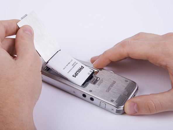

  2. Philips DPM8000 Display Replacement, Battery Lid: crwdns2935265:02crwdnd2935265:01crwdnd2935265:02crwdne2935265:0 Philips DPM8000 Display Replacement, Battery Lid: crwdns2935265:02crwdnd2935265:02crwdnd2935265:02crwdne2935265:0
    • Remove the battery lid
  3. Philips DPM8000 Display Replacement, Battery: crwdns2935265:03crwdnd2935265:01crwdnd2935265:02crwdne2935265:0 Philips DPM8000 Display Replacement, Battery: crwdns2935265:03crwdnd2935265:02crwdnd2935265:02crwdne2935265:0
    • Remove the battery.
    • The battery lid is designed to function as an instrument for this task.

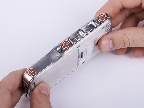

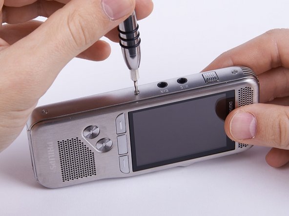

  4. Philips DPM8000 Display Replacement, Upper Ornamental Part: crwdns2935265:04crwdnd2935265:01crwdnd2935265:03crwdne2935265:0 Philips DPM8000 Display Replacement, Upper Ornamental Part: crwdns2935265:04crwdnd2935265:02crwdnd2935265:03crwdne2935265:0 Philips DPM8000 Display Replacement, Upper Ornamental Part: crwdns2935265:04crwdnd2935265:03crwdnd2935265:03crwdne2935265:0
    • Unscrew the six Torx #4 (5,3 mm) screws from both sides of the device
    • Collect the removed screws in a bowl or something comparable, otherwise they might get lost.

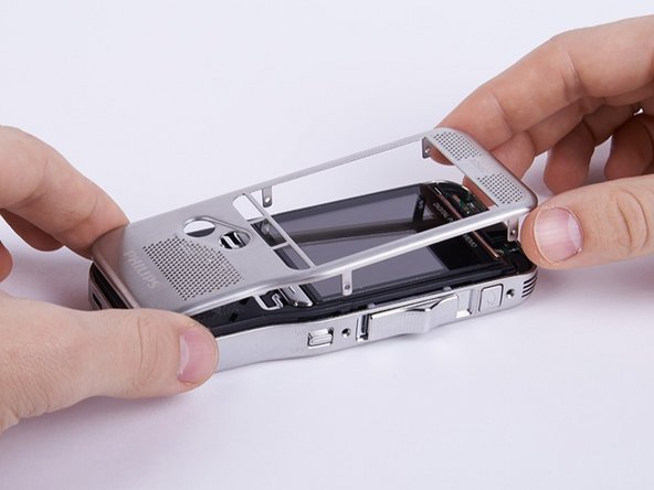

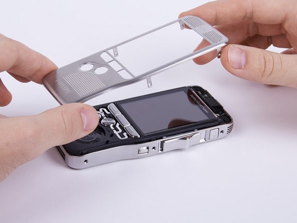

  5. Philips DPM8000 Display Replacement: crwdns2935265:05crwdnd2935265:01crwdnd2935265:03crwdne2935265:0 Philips DPM8000 Display Replacement: crwdns2935265:05crwdnd2935265:02crwdnd2935265:03crwdne2935265:0 Philips DPM8000 Display Replacement: crwdns2935265:05crwdnd2935265:03crwdnd2935265:03crwdne2935265:0
    • Remove the upper ornamental part from the housing.
    • If your fingernails are not long enough you can use a plastic opening tool.
    • When reassembling the device be aware that the six shackles on the sides of the upper ornamental part need to be placed inside the frame.

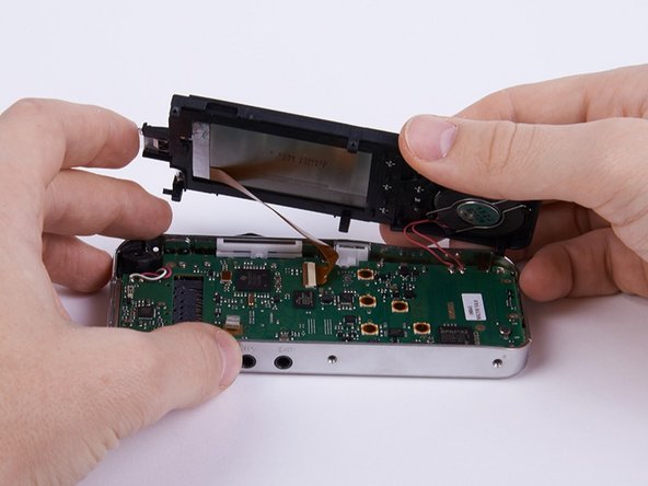

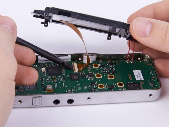

  6. Philips DPM8000 Display Replacement, Housing/Display: crwdns2935265:06crwdnd2935265:01crwdnd2935265:02crwdne2935265:0 Philips DPM8000 Display Replacement, Housing/Display: crwdns2935265:06crwdnd2935265:02crwdnd2935265:02crwdne2935265:0
    • Lift up the housing.
    • The display as well as the speaker are connected to the motherboard. Therefore you need to be careful not to harm those connections.

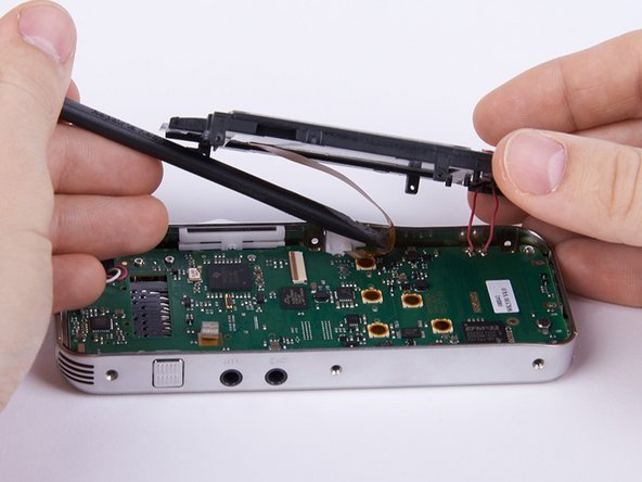

  7. Philips DPM8000 Display Replacement: crwdns2935265:07crwdnd2935265:01crwdnd2935265:02crwdne2935265:0 Philips DPM8000 Display Replacement: crwdns2935265:07crwdnd2935265:02crwdnd2935265:02crwdne2935265:0
    • Unlock the connection between display and motherboard by pushing open the brown cleat.
    • It is recommended to use a spudger or a comparable tool for this step.
    • If the connection is not completely open, one of the involved components could easily be harmed.
  8. Philips DPM8000 Display Replacement: crwdns2935265:08crwdnd2935265:01crwdnd2935265:02crwdne2935265:0 Philips DPM8000 Display Replacement: crwdns2935265:08crwdnd2935265:02crwdnd2935265:02crwdne2935265:0
    • Separate the connection by pulling out the display cable.
    • If the cable does not come out easily, the connection is probably still locked.
    • When reconnecting the display to the motherboard don't forget to lock the connection, otherwise it will eventually come loose and you will have to redo the first eight steps of this guide.

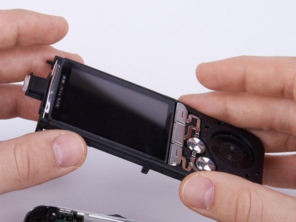

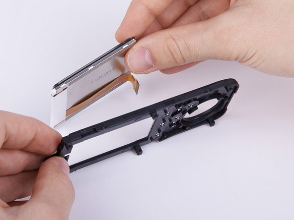

  9. Philips DPM8000 Display Replacement, Defective Display: crwdns2935265:09crwdnd2935265:01crwdnd2935265:02crwdne2935265:0 Philips DPM8000 Display Replacement, Defective Display: crwdns2935265:09crwdnd2935265:02crwdnd2935265:02crwdne2935265:0
    • Abstract the defective display from the housing.
  10. Philips DPM8000 Display Replacement, New Display: crwdns2935265:010crwdnd2935265:01crwdnd2935265:02crwdne2935265:0 Philips DPM8000 Display Replacement, New Display: crwdns2935265:010crwdnd2935265:02crwdnd2935265:02crwdne2935265:0
    • Place the new display in the housing.
    • Until the fall of 2015 the DPM8000 was delivered with a display and a separated display glass. Since then the display and the glass come as one part.
To reassemble your device, follow these instructions in reverse order beginning with step 8.
