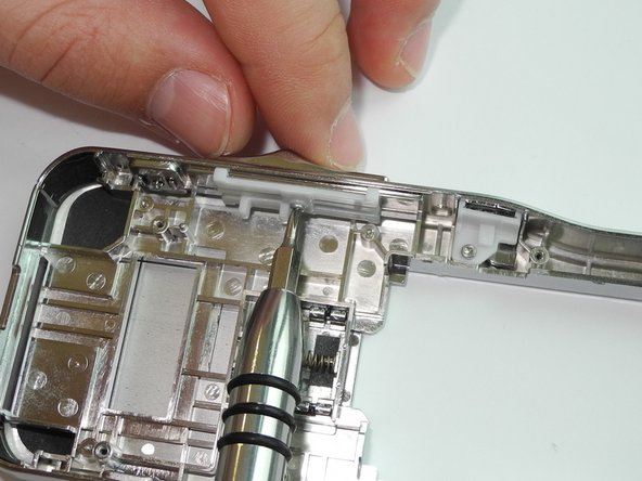

  14. Philips DPM8000 BA-Slider Replacement, BA-Slider: crwdns2935265:014crwdnd2935265:01crwdnd2935265:01crwdne2935265:0
    • Remove the sliding cage.
    • When reassembling the device please make sure that the spring in the sliding cage is positioned on the bottom side of the device.
  15. Philips DPM8000 BA-Slider Replacement: crwdns2935265:015crwdnd2935265:01crwdnd2935265:02crwdne2935265:0 Philips DPM8000 BA-Slider Replacement: crwdns2935265:015crwdnd2935265:02crwdnd2935265:02crwdne2935265:0
    • Unscrew one crossed slot screw PH00 (4,5 mm).
  16. Philips DPM8000 BA-Slider Replacement: crwdns2935265:016crwdnd2935265:01crwdnd2935265:01crwdne2935265:0
    • Remove the defective BA-Slider and replace it with the new one.
To reassemble your device, follow these instructions in reverse order beginning with step 15.
