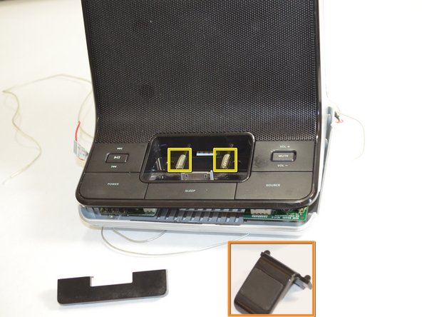

    3. Philips DC320 37 Connector Replacement: crwdns2935265:07crwdnd2935265:01crwdnd2935265:03crwdne2935265:0 Philips DC320 37 Connector Replacement: crwdns2935265:07crwdnd2935265:02crwdnd2935265:03crwdne2935265:0 Philips DC320 37 Connector Replacement: crwdns2935265:07crwdnd2935265:03crwdnd2935265:03crwdne2935265:0
      • Turn the dock so that you are looking at the front of the dock.
      • Pull out the black U-shaped piece.
      • Pull out the iPhone/iPod support cradle.
      • Pull out the two springs.
