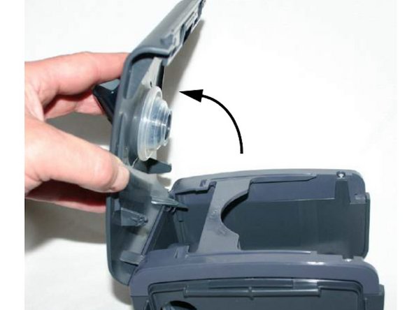

    • Remove the Water Chamber Assembly.
    • Gently squeeze the latch on the Flip Lid Assembly to release it.
    • Lift the Flip Lid Assembly.
    • Pull the Humidifier Tank Assembly out of the Humidifier.

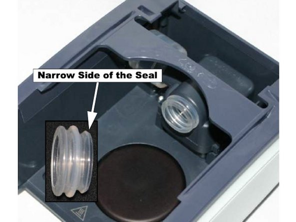

  3. Philips BiPAP S/T Humidifier Replacement: crwdns2935265:03crwdnd2935265:01crwdnd2935265:02crwdne2935265:0 Philips BiPAP S/T Humidifier Replacement: crwdns2935265:03crwdnd2935265:02crwdnd2935265:02crwdne2935265:0
    • Remove the Dry Box Seal.
    • If this is the source of error, place this part with a new one.
    • When replacing, ensure that the narrow end of the seal is inserted into the Dry Box.

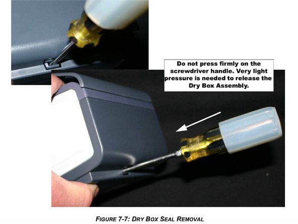

  4. Philips BiPAP S/T Humidifier Replacement: crwdns2935265:04crwdnd2935265:01crwdnd2935265:02crwdne2935265:0 Philips BiPAP S/T Humidifier Replacement: crwdns2935265:04crwdnd2935265:02crwdnd2935265:02crwdne2935265:0
    • Remove the Dry Box Assembly.
    • Insert a flat blade screwdriver into the hole located on the back of the Humidifier and lightly press inward to release the Dry Box Assembly.
    • Do not press firmly on the screwdriver as damage may occur.
    • Remove the Inlet Seal from the Dry Box Assembly

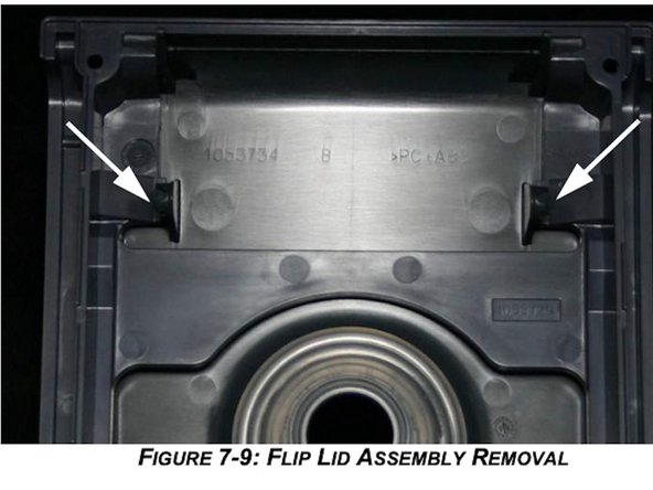

  5. Philips BiPAP S/T Humidifier Replacement: crwdns2935265:05crwdnd2935265:01crwdnd2935265:03crwdne2935265:0 Philips BiPAP S/T Humidifier Replacement: crwdns2935265:05crwdnd2935265:02crwdnd2935265:03crwdne2935265:0 Philips BiPAP S/T Humidifier Replacement: crwdns2935265:05crwdnd2935265:03crwdnd2935265:03crwdne2935265:0
    • Remove the Flip Lid Assembly.
    • Use a screwdriver to push in on the latches that secure the Flip Lid Assembly to the Humidifier Top Housing.
    • Bend the Flip Lid Assembly completely backwards until it is removed.
    • For Heated Tube devices, remove the wire harness from the base.

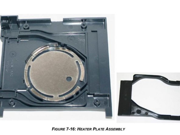

  9. Philips BiPAP S/T Humidifier Replacement: crwdns2935265:09crwdnd2935265:01crwdnd2935265:02crwdne2935265:0 Philips BiPAP S/T Humidifier Replacement: crwdns2935265:09crwdnd2935265:02crwdnd2935265:02crwdne2935265:0
    • Remove the Heater Plate Assembly.
    • The Heater Plate Assembly is secured by two small tabs.
    • Once replaced, secure the Bottom Housing to the Lower Base using the four #6 x 1/4" screws.
    • Be sure the Heater Plate Spring is properly seated under the Heater Plate.
