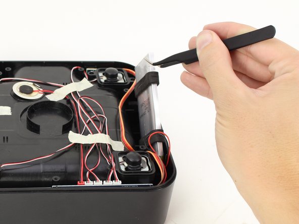

    • Take the battery out of the SmartBowl with tweezers, avoid pulling on any wires.
    • Hold the SmartBowl down using one hand while using the other hand to remove the battery.
  4. Petnet SmartFeeder SF10E Charging Assembly Replacement: crwdns2935265:04crwdnd2935265:01crwdnd2935265:02crwdne2935265:0 Petnet SmartFeeder SF10E Charging Assembly Replacement: crwdns2935265:04crwdnd2935265:02crwdnd2935265:02crwdne2935265:0
    • Remove the tape, closest to the four white connectors, with your hands.
    • Keep the wires attached to the tape for easy reassembly.

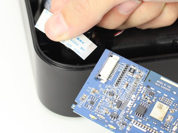

  7. Petnet SmartFeeder SF10E Charging Assembly Replacement: crwdns2935265:07crwdnd2935265:01crwdnd2935265:02crwdne2935265:0 Petnet SmartFeeder SF10E Charging Assembly Replacement: crwdns2935265:07crwdnd2935265:02crwdnd2935265:02crwdne2935265:0
    • Push both small gray pieces next to the ribbon connector towards the ribbon to put them in the “open” position using the nylon spudger.
  8. Petnet SmartFeeder SF10E Charging Assembly Replacement: crwdns2935265:08crwdnd2935265:01crwdnd2935265:02crwdne2935265:0 Petnet SmartFeeder SF10E Charging Assembly Replacement: crwdns2935265:08crwdnd2935265:02crwdnd2935265:02crwdne2935265:0
    • Remove the ribbon connector from its slot by pulling on it with a couple fingers.
    • The ribbon should come out easily with the gray pieces in the "open" position. Do not use too much force with the ribbon or it could be damaged.
    • Make sure the gray pieces are in the “open” position when you reassemble the ribbon connector or the connector will not go into its slot. Once the connector is in the slot, slide the gray tabs back down into the “closed” position

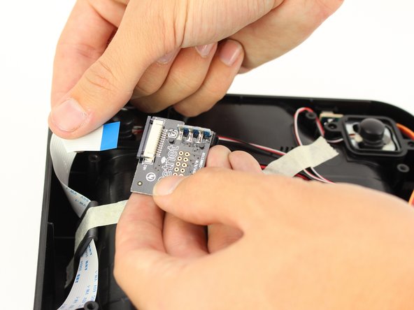

  9. Petnet SmartFeeder SF10E Charging Assembly Replacement, Charging Assembly: crwdns2935265:09crwdnd2935265:01crwdnd2935265:02crwdne2935265:0 Petnet SmartFeeder SF10E Charging Assembly Replacement, Charging Assembly: crwdns2935265:09crwdnd2935265:02crwdnd2935265:02crwdne2935265:0
    • Use the nylon spudger to remove the charging assembly from the SmartBowl.
  10. Petnet SmartFeeder SF10E Charging Assembly Replacement: crwdns2935265:010crwdnd2935265:01crwdnd2935265:02crwdne2935265:0 Petnet SmartFeeder SF10E Charging Assembly Replacement: crwdns2935265:010crwdnd2935265:02crwdnd2935265:02crwdne2935265:0
    • Push the small gray pieces on the ribbon connector into the “open” position with the nylon spudger.
    • Do not to use too much force when removing the ribbon or any of the electrical components because they are sensitive and delicate.
  11. Petnet SmartFeeder SF10E Charging Assembly Replacement: crwdns2935265:011crwdnd2935265:01crwdnd2935265:02crwdne2935265:0 Petnet SmartFeeder SF10E Charging Assembly Replacement: crwdns2935265:011crwdnd2935265:02crwdnd2935265:02crwdne2935265:0
    • Pull the ribbon connector out of its slot using one hand and another hand on the base of the charging assembly.
