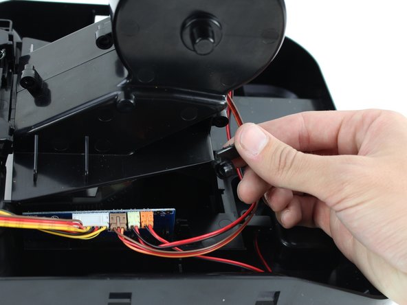

  4. Petnet SmartFeeder SF10E 12 Pin Connector Replacement: crwdns2935265:04crwdnd2935265:01crwdnd2935265:01crwdne2935265:0
    • Flip over the SmartFeeder by using both hands.
    • Partially open the outer case of the SmartFeeder by wedging an iFixit Opening Tool on each side.

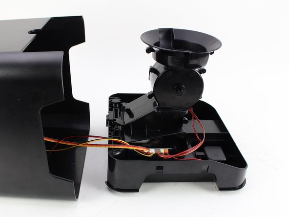

  5. Petnet SmartFeeder SF10E 12 Pin Connector Replacement: crwdns2935265:05crwdnd2935265:01crwdnd2935265:02crwdne2935265:0 Petnet SmartFeeder SF10E 12 Pin Connector Replacement: crwdns2935265:05crwdnd2935265:02crwdnd2935265:02crwdne2935265:0
    • Turn the SmartFeeder on its side and with one hand on the base, carefully pull out the central section.
    • Place the bottom piece of the device right-side up.

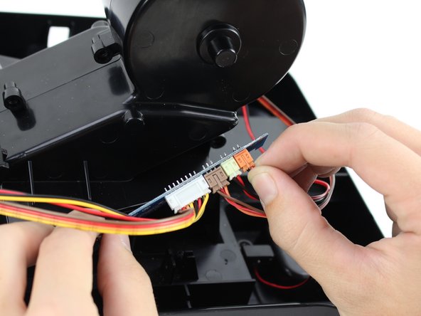

  6. Petnet SmartFeeder SF10E 12 Pin Connector Replacement: crwdns2935265:06crwdnd2935265:01crwdnd2935265:02crwdne2935265:0 Petnet SmartFeeder SF10E 12 Pin Connector Replacement: crwdns2935265:06crwdnd2935265:02crwdnd2935265:02crwdne2935265:0
    • Remove one 10 mm screw by using the Phillips #1 screwdriver.
    • Remove the plastic retaining piece for the daughterboard by pulling it out with one hand.

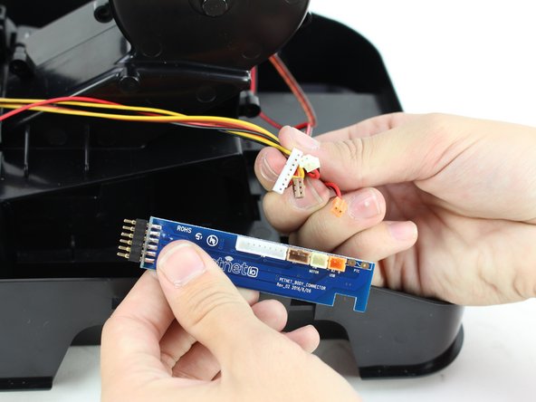

  7. Petnet SmartFeeder SF10E 12 Pin Connector Replacement: crwdns2935265:07crwdnd2935265:01crwdnd2935265:03crwdne2935265:0 Petnet SmartFeeder SF10E 12 Pin Connector Replacement: crwdns2935265:07crwdnd2935265:02crwdnd2935265:03crwdne2935265:0 Petnet SmartFeeder SF10E 12 Pin Connector Replacement: crwdns2935265:07crwdnd2935265:03crwdnd2935265:03crwdne2935265:0
    • Pull the daughterboard out of the device and remove the three-prong connectors by using your hands.
    • Hold onto the sockets on the motherboard or you could accidentally pull off the entire assembly.
