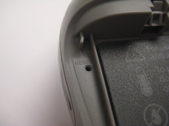

  3. Performing Delphi MyFi XM2GO Hard Reset, Performing Delphi MyFi XM2GO Hard Reset: crwdns2935265:03crwdnd2935265:01crwdnd2935265:02crwdne2935265:0 Performing Delphi MyFi XM2GO Hard Reset, Performing Delphi MyFi XM2GO Hard Reset: crwdns2935265:03crwdnd2935265:02crwdnd2935265:02crwdne2935265:0
    • After removing the battery cover and battery, locate the reset (indicated by arrow).
  4. Performing Delphi MyFi XM2GO Hard Reset: crwdns2935265:04crwdnd2935265:01crwdnd2935265:01crwdne2935265:0
    • Unbend the paper clip, making it straight. CAUTION: The ends may be sharp.
    • Carefully insert one end of the paper clip into the hole to reset the device.
