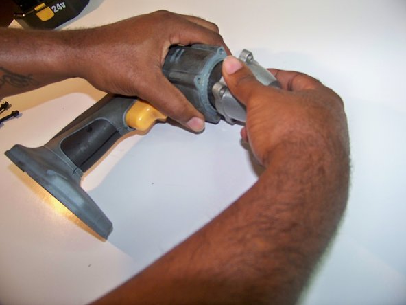

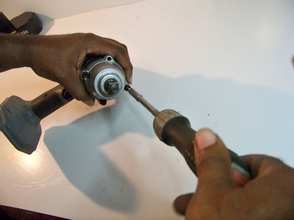

    • Use a T-25 hex bit to remove four 1'1/2 hex head screws.
  4. Performance Tool W50042 Trigger Switch Replacement: crwdns2935265:04crwdnd2935265:01crwdnd2935265:03crwdne2935265:0 Performance Tool W50042 Trigger Switch Replacement: crwdns2935265:04crwdnd2935265:02crwdnd2935265:03crwdne2935265:0 Performance Tool W50042 Trigger Switch Replacement: crwdns2935265:04crwdnd2935265:03crwdnd2935265:03crwdne2935265:0

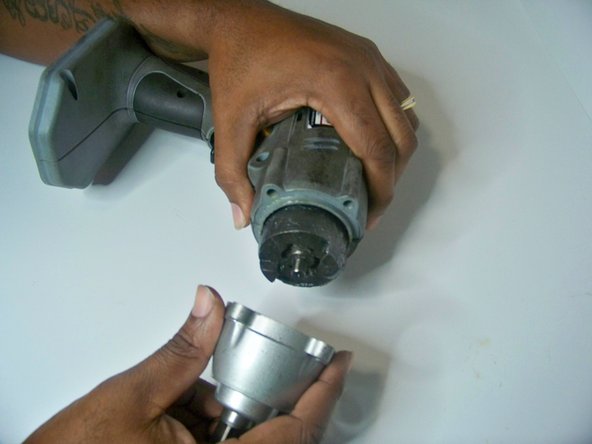

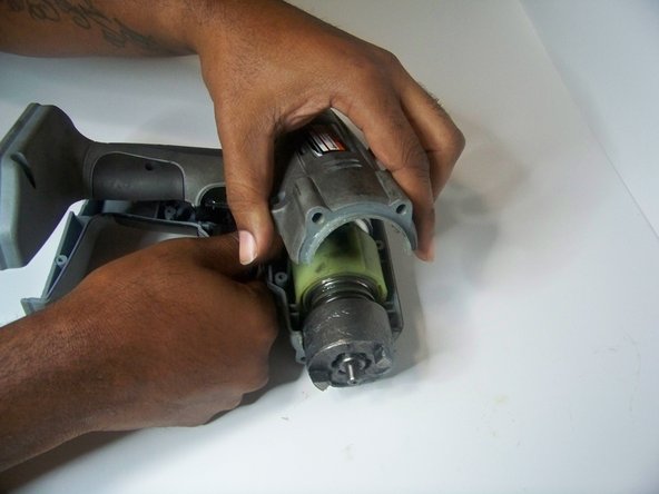

    • Remove the shaft cover.
  5. Performance Tool W50042 Trigger Switch Replacement: crwdns2935265:05crwdnd2935265:01crwdnd2935265:03crwdne2935265:0 Performance Tool W50042 Trigger Switch Replacement: crwdns2935265:05crwdnd2935265:02crwdnd2935265:03crwdne2935265:0 Performance Tool W50042 Trigger Switch Replacement: crwdns2935265:05crwdnd2935265:03crwdnd2935265:03crwdne2935265:0

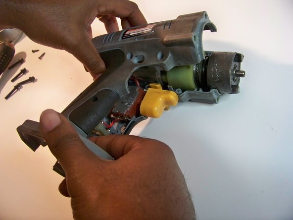

    • Remove the case.
  6. Performance Tool W50042 Trigger Switch Replacement: crwdns2935265:06crwdnd2935265:01crwdnd2935265:03crwdne2935265:0 Performance Tool W50042 Trigger Switch Replacement: crwdns2935265:06crwdnd2935265:02crwdnd2935265:03crwdne2935265:0 Performance Tool W50042 Trigger Switch Replacement: crwdns2935265:06crwdnd2935265:03crwdnd2935265:03crwdne2935265:0

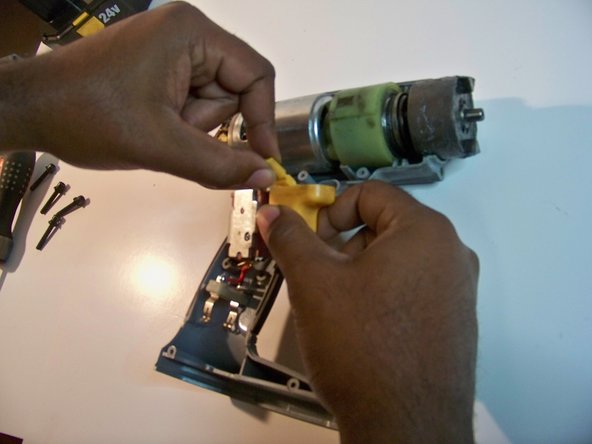

    • Lift the trigger switch to remove the direction switch.

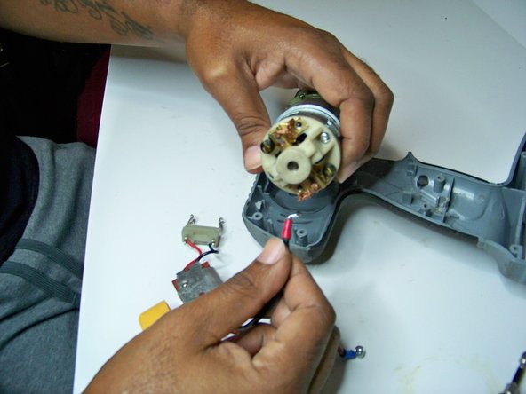

  7. Performance Tool W50042 Trigger Switch Replacement: crwdns2935265:07crwdnd2935265:01crwdnd2935265:03crwdne2935265:0 Performance Tool W50042 Trigger Switch Replacement: crwdns2935265:07crwdnd2935265:02crwdnd2935265:03crwdne2935265:0 Performance Tool W50042 Trigger Switch Replacement: crwdns2935265:07crwdnd2935265:03crwdnd2935265:03crwdne2935265:0

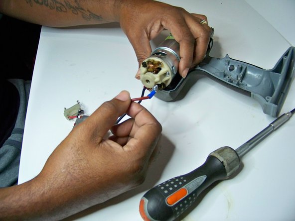

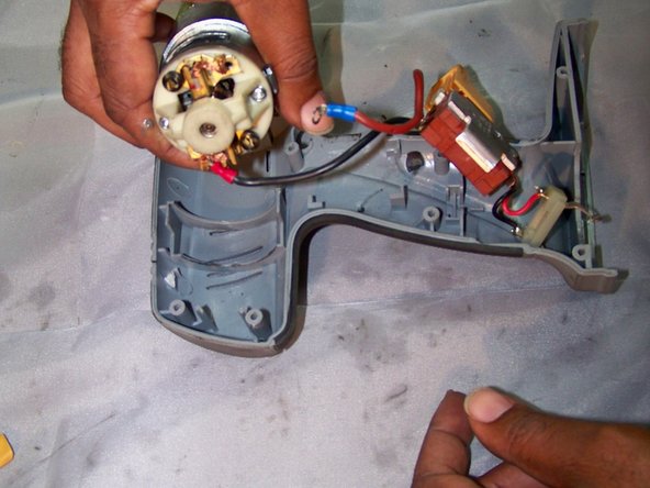

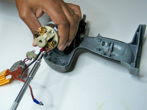

    • Unscrew the red wire from the motor (Phillips head screw 1/4 inch).
  8. Performance Tool W50042 Trigger Switch Replacement: crwdns2935265:08crwdnd2935265:01crwdnd2935265:03crwdne2935265:0 Performance Tool W50042 Trigger Switch Replacement: crwdns2935265:08crwdnd2935265:02crwdnd2935265:03crwdne2935265:0 Performance Tool W50042 Trigger Switch Replacement: crwdns2935265:08crwdnd2935265:03crwdnd2935265:03crwdne2935265:0
    • Pick up the motor and remove the black wire (Phillips head screw 1/4 inch).
