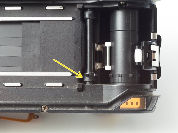

  8. Pentax ZX-5n Sprocket Counter PCB Replacement, Remove transport gears: crwdns2935265:08crwdnd2935265:01crwdnd2935265:02crwdne2935265:0 Pentax ZX-5n Sprocket Counter PCB Replacement, Remove transport gears: crwdns2935265:08crwdnd2935265:02crwdnd2935265:02crwdne2935265:0
    • It's best to remove these parts now so they don't fall out later on in the repair.

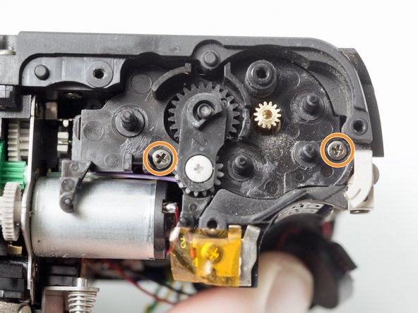

  9. Pentax ZX-5n Sprocket Counter PCB Replacement, Remove transport gear carrier: crwdns2935265:09crwdnd2935265:01crwdnd2935265:03crwdne2935265:0 Pentax ZX-5n Sprocket Counter PCB Replacement, Remove transport gear carrier: crwdns2935265:09crwdnd2935265:02crwdnd2935265:03crwdne2935265:0 Pentax ZX-5n Sprocket Counter PCB Replacement, Remove transport gear carrier: crwdns2935265:09crwdnd2935265:03crwdnd2935265:03crwdne2935265:0
    • Gently pull the speaker from its retention posts.
    • Remove two 5.1 mm #00 screws.
    • Installation Notes: The transport gear carrier mates with the sprocket shaft here using a squared off spindle. Make sure they mate properly when reassembled.

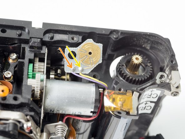

  10. Pentax ZX-5n Sprocket Counter PCB Replacement, Remove sprocket counter PCB: crwdns2935265:010crwdnd2935265:01crwdnd2935265:02crwdne2935265:0 Pentax ZX-5n Sprocket Counter PCB Replacement, Remove sprocket counter PCB: crwdns2935265:010crwdnd2935265:02crwdnd2935265:02crwdne2935265:0
    • Remove one X mm screw.
    • The screw has atypical threads with a very steep angle. It will want to move in/out with relatively little rotation.
    • Unsolder one purple wire.
    • Unsolder one yellow wire.
