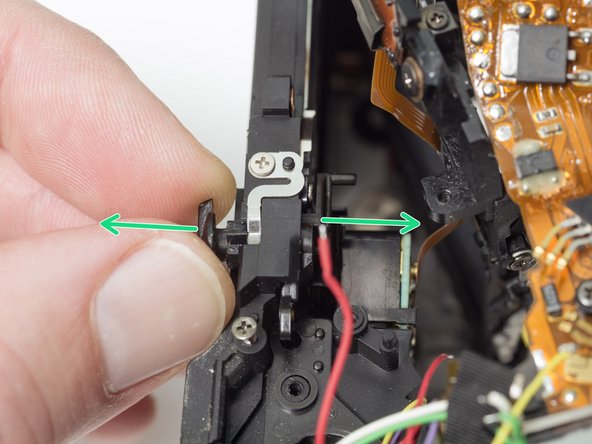

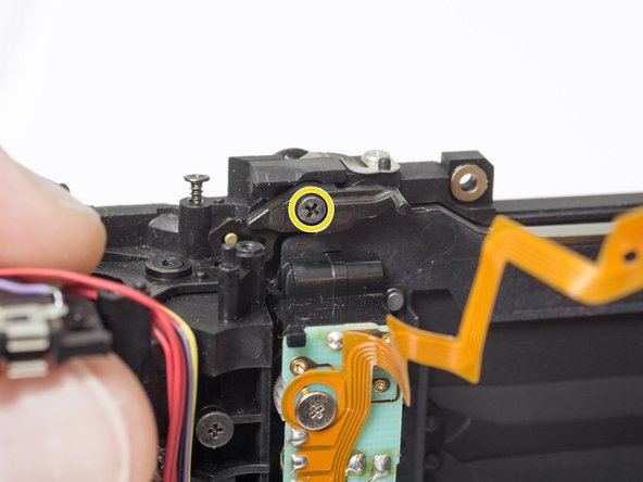

  28. Pentax ZX-5n Shutter Unit Replacement, Remove panorama switch: crwdns2935265:028crwdnd2935265:01crwdnd2935265:03crwdne2935265:0 Pentax ZX-5n Shutter Unit Replacement, Remove panorama switch: crwdns2935265:028crwdnd2935265:02crwdnd2935265:03crwdne2935265:0 Pentax ZX-5n Shutter Unit Replacement, Remove panorama switch: crwdns2935265:028crwdnd2935265:03crwdnd2935265:03crwdne2935265:0
    • Remove one X mm #00 screw.
    • Remove panorama switch contact.
    • Pull panorama switch apart and remove both pieces.
