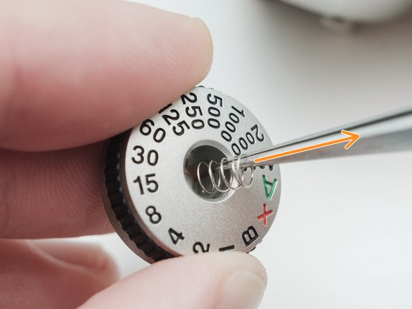

  15. Pentax ZX-5n Shutter Speed Dial Replacement, Remove dial: crwdns2935265:015crwdnd2935265:01crwdnd2935265:01crwdne2935265:0
    • Slide the exposure compensation dial out of the top cover.
    • If the dial was not set to 'A' in Step 10, the knob will not slide out. Turning the knob at this stage could damage the detent spring.
  16. Pentax ZX-5n Shutter Speed Dial Replacement, Remove detent components: crwdns2935265:016crwdnd2935265:01crwdnd2935265:02crwdne2935265:0 Pentax ZX-5n Shutter Speed Dial Replacement, Remove detent components: crwdns2935265:016crwdnd2935265:02crwdnd2935265:02crwdne2935265:0
    • Remove the ball bearing from the inside of the dial.
    • Remove the detent spring from the top cover.
  17. Pentax ZX-5n Shutter Speed Dial Replacement, Remove lock button: crwdns2935265:017crwdnd2935265:01crwdnd2935265:02crwdne2935265:0 Pentax ZX-5n Shutter Speed Dial Replacement, Remove lock button: crwdns2935265:017crwdnd2935265:02crwdnd2935265:02crwdne2935265:0
    • Use tweezers to release the snaps on the lock button.
    • Remove the lock button from the top of the dial.
  18. Pentax ZX-5n Shutter Speed Dial Replacement, Remove inner components: crwdns2935265:018crwdnd2935265:01crwdnd2935265:02crwdne2935265:0 Pentax ZX-5n Shutter Speed Dial Replacement, Remove inner components: crwdns2935265:018crwdnd2935265:02crwdnd2935265:02crwdne2935265:0
    • Remove lock actuator.
    • Remove lock spring.
