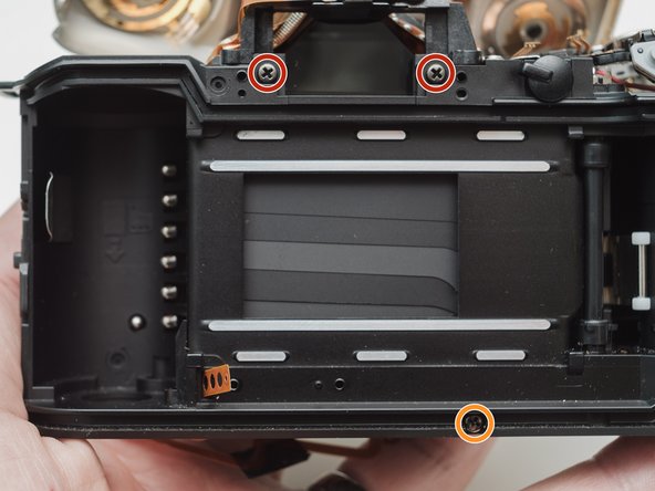

  6. Pentax ZX-5n Mirror Motor Gear Replacement, Remove eye cup: crwdns2935265:06crwdnd2935265:01crwdnd2935265:01crwdne2935265:0
    • Slide the eye cup up and off to access the screws underneath.

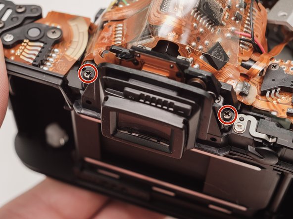

  7. Pentax ZX-5n Mirror Motor Gear Replacement, Unscrew top cover: crwdns2935265:07crwdnd2935265:01crwdnd2935265:03crwdne2935265:0 Pentax ZX-5n Mirror Motor Gear Replacement, Unscrew top cover: crwdns2935265:07crwdnd2935265:02crwdnd2935265:03crwdne2935265:0 Pentax ZX-5n Mirror Motor Gear Replacement, Unscrew top cover: crwdns2935265:07crwdnd2935265:03crwdnd2935265:03crwdne2935265:0
    • Remove two 5.3 mm #00 screws by the eyepiece.
    • Remove one 6.8 mm #00 screw in the battery compartment.
    • Remove one 7.0 mm #00 screw near the take up spool.

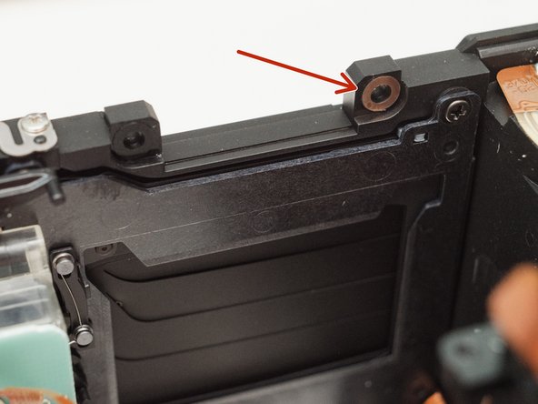

  27. Pentax ZX-5n Mirror Motor Gear Replacement, Check for shims: crwdns2935265:027crwdnd2935265:01crwdnd2935265:01crwdne2935265:0
    • There may be shims at the mounting points of the front housing block.
    • Note the positions and remove if loose.
