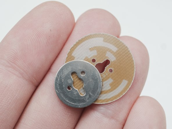

    • Remove the contact PCB.
    • There is a metal plate underneath that may stick to the PCB.

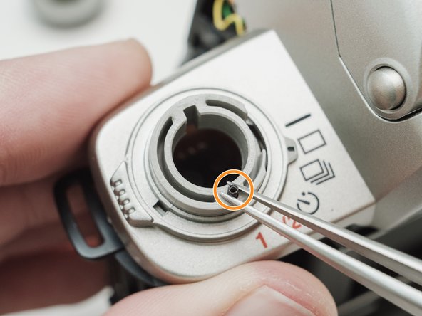

  16. Pentax ZX-5n Exposure Compensation Dial Replacement, Remove detent components: crwdns2935265:016crwdnd2935265:01crwdnd2935265:02crwdne2935265:0 Pentax ZX-5n Exposure Compensation Dial Replacement, Remove detent components: crwdns2935265:016crwdnd2935265:02crwdnd2935265:02crwdne2935265:0
    • Remove the ball bearing from the inside of the dial.
    • Remove the detent spring from the top cover.
