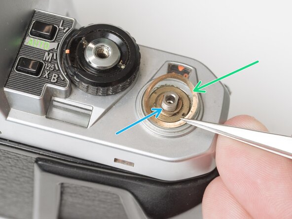

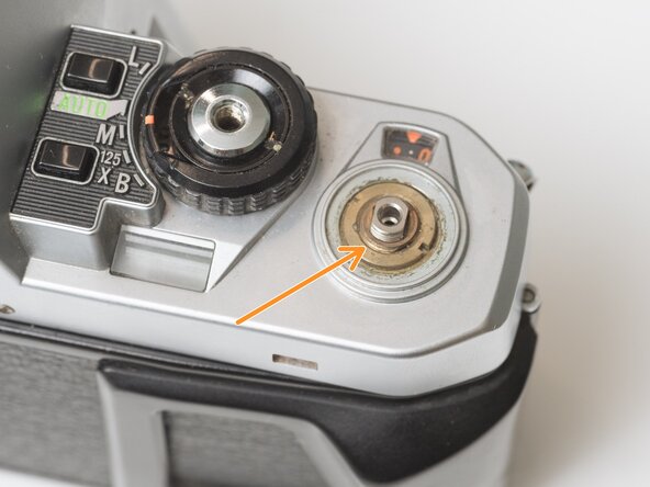

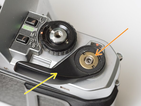

  1. Pentax Super Program Top Cover Removal, Remove film advance lever: crwdns2935265:01crwdnd2935265:01crwdnd2935265:03crwdne2935265:0 Pentax Super Program Top Cover Removal, Remove film advance lever: crwdns2935265:01crwdnd2935265:02crwdnd2935265:03crwdne2935265:0 Pentax Super Program Top Cover Removal, Remove film advance lever: crwdns2935265:01crwdnd2935265:03crwdnd2935265:03crwdne2935265:0
    • Remove the rubber decorative cap. It is attached with contact cement underneath. Isopropyl Alcohol may be used to soften the adhesive.
    • Unscrew the lock nut using a spanner wrench. The lock nut is reverse threaded.
    • Lift off the advance lever.
    • Remove the spring washer.
    • Remove one shim washer.

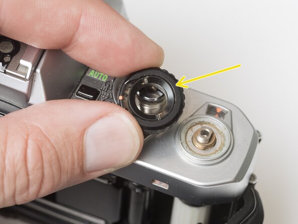

  2. Pentax Super Program Top Cover Removal, Remove mode dial: crwdns2935265:02crwdnd2935265:01crwdnd2935265:02crwdne2935265:0 Pentax Super Program Top Cover Removal, Remove mode dial: crwdns2935265:02crwdnd2935265:02crwdnd2935265:02crwdne2935265:0
    • Set the mode dial to the 'L' position.
    • Use a spanner wrench to unscrew the dial lock nut.
    • Lift off the mode dial.

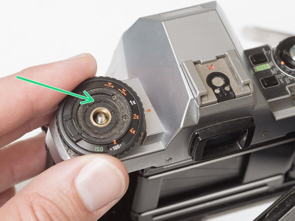

  3. Pentax Super Program Top Cover Removal, Remove exposure compensation dial: crwdns2935265:03crwdnd2935265:01crwdnd2935265:03crwdne2935265:0 Pentax Super Program Top Cover Removal, Remove exposure compensation dial: crwdns2935265:03crwdnd2935265:02crwdnd2935265:03crwdne2935265:0 Pentax Super Program Top Cover Removal, Remove exposure compensation dial: crwdns2935265:03crwdnd2935265:03crwdnd2935265:03crwdne2935265:0

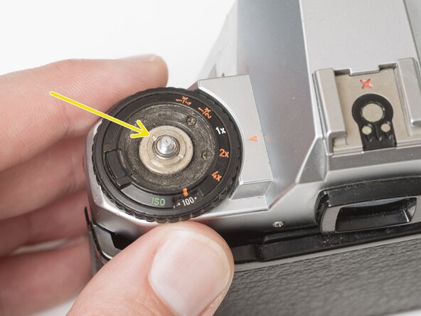

    • Place a rigid object in the fork.
    • Unscrew the rewind lever.
    • Use a spanner wrench to remove the lock nut.
    • Lift off the exposure compensation dial.

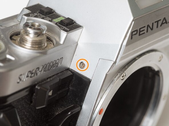

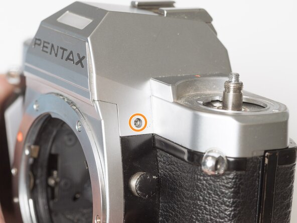

  4. Pentax Super Program Top Cover Removal, Remove top cover screws: crwdns2935265:04crwdnd2935265:01crwdnd2935265:03crwdne2935265:0 Pentax Super Program Top Cover Removal, Remove top cover screws: crwdns2935265:04crwdnd2935265:02crwdnd2935265:03crwdne2935265:0 Pentax Super Program Top Cover Removal, Remove top cover screws: crwdns2935265:04crwdnd2935265:03crwdnd2935265:03crwdne2935265:0
    • Remove two screws on either side of the eye piece.
    • Remove two screws on either side of the lens mount.

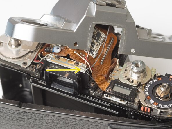

  5. Pentax Super Program Top Cover Removal, Remove top cover: crwdns2935265:05crwdnd2935265:01crwdnd2935265:03crwdne2935265:0 Pentax Super Program Top Cover Removal, Remove top cover: crwdns2935265:05crwdnd2935265:02crwdnd2935265:03crwdne2935265:0 Pentax Super Program Top Cover Removal, Remove top cover: crwdns2935265:05crwdnd2935265:03crwdnd2935265:03crwdne2935265:0
    • Remove one screw by the exposure compensation dial.
    • Use a spanner wrench to remove the lock nut under the advance lever.
    • Lift off the top cover slowly. It is still attached by one wire.
    • Unsolder one gray flash sync wire.
