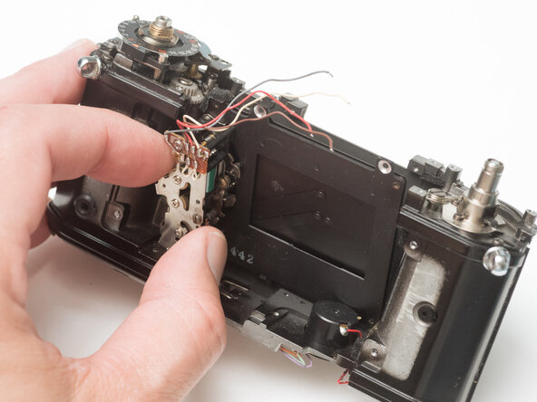

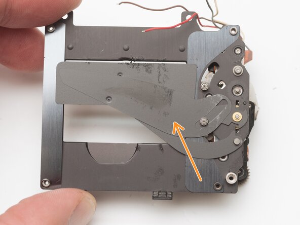

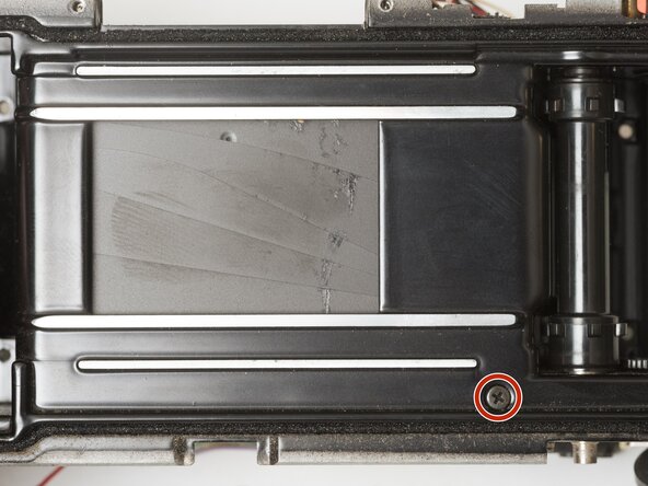

    1. Pentax Super Program Shutter Service, Remove shutter unit: crwdns2935265:019crwdnd2935265:01crwdnd2935265:03crwdne2935265:0 Pentax Super Program Shutter Service, Remove shutter unit: crwdns2935265:019crwdnd2935265:02crwdnd2935265:03crwdne2935265:0 Pentax Super Program Shutter Service, Remove shutter unit: crwdns2935265:019crwdnd2935265:03crwdnd2935265:03crwdne2935265:0
      • Remove three M1.7 x 3 mm screws.
      • Lift shutter unit out of camera body.
    2. Pentax Super Program Shutter Service, Release the shutter: crwdns2935265:020crwdnd2935265:01crwdnd2935265:01crwdne2935265:0
      • Push the shutter release latch down to fire the shutter.
      • Reducing the tension of the shutter springs makes disassembly and reassembly easier.

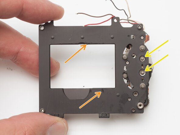

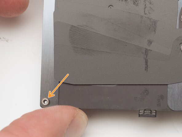

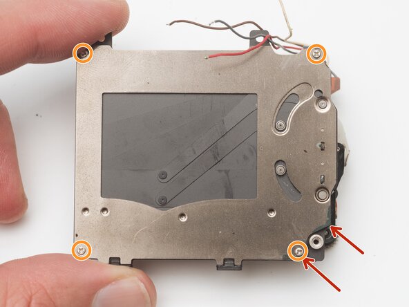

    3. Pentax Super Program Shutter Service, Remove rear plate: crwdns2935265:021crwdnd2935265:01crwdnd2935265:03crwdne2935265:0 Pentax Super Program Shutter Service, Remove rear plate: crwdns2935265:021crwdnd2935265:02crwdnd2935265:03crwdne2935265:0 Pentax Super Program Shutter Service, Remove rear plate: crwdns2935265:021crwdnd2935265:03crwdnd2935265:03crwdne2935265:0
      • Remove old foam seals.
      • Foam seals should be replaced with new material during reassembly.
      • Remove four M1.4 x 2.4 mm screws.
      • Remove top spacer bushing.

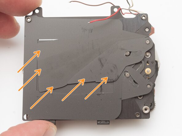

    4. Pentax Super Program Shutter Service, Remove closing curtain: crwdns2935265:022crwdnd2935265:01crwdnd2935265:02crwdne2935265:0 Pentax Super Program Shutter Service, Remove closing curtain: crwdns2935265:022crwdnd2935265:02crwdnd2935265:02crwdne2935265:0
      • Remove closing curtain linkage.
      • Remove five curtain blades.
      • Installation Notes: Make sure the helper spring is properly hooked on the closing curtain linkage when reassembled.

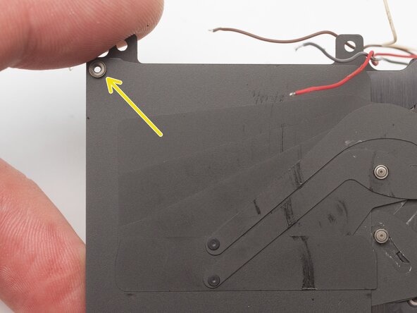

    6. Pentax Super Program Shutter Service, Remove opening curtain: crwdns2935265:024crwdnd2935265:01crwdnd2935265:02crwdne2935265:0 Pentax Super Program Shutter Service, Remove opening curtain: crwdns2935265:024crwdnd2935265:02crwdnd2935265:02crwdne2935265:0
      • Remove three curtain blades.
      • Remove opening curtain linkage.

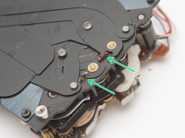

    7. Pentax Super Program Shutter Service, Clean the shutter: crwdns2935265:025crwdnd2935265:01crwdnd2935265:03crwdne2935265:0 Pentax Super Program Shutter Service, Clean the shutter: crwdns2935265:025crwdnd2935265:02crwdnd2935265:03crwdne2935265:0 Pentax Super Program Shutter Service, Clean the shutter: crwdns2935265:025crwdnd2935265:03crwdnd2935265:03crwdne2935265:0
      • Remove two curtain guides.
      • Clean any residue from the shutter frame and blades using isopropyl alcohol or other solvent.
      • Clean the curtain pivots.
      • Remove degraded rubber dampers and clean the surrounding area. They do not need to be replaced.
