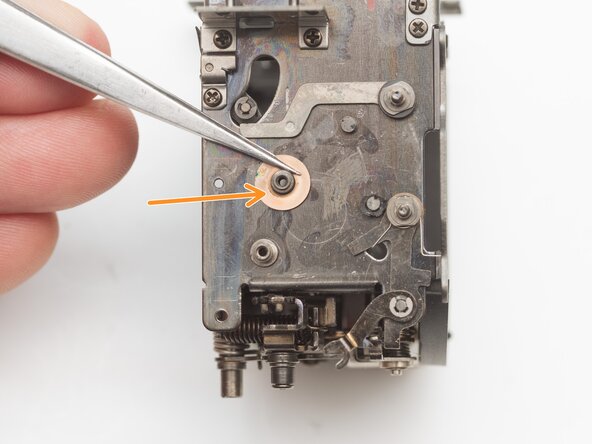

  27. Pentax Super Program Mirror Box Mechanism Service, Installation Notes: Mirror Box: crwdns2935265:027crwdnd2935265:01crwdnd2935265:02crwdne2935265:0 Pentax Super Program Mirror Box Mechanism Service, Installation Notes: Mirror Box: crwdns2935265:027crwdnd2935265:02crwdnd2935265:02crwdne2935265:0
    • Check the coupling points for the aperture control, depth of field preview and self-time when reassembling the mirror box.

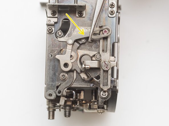

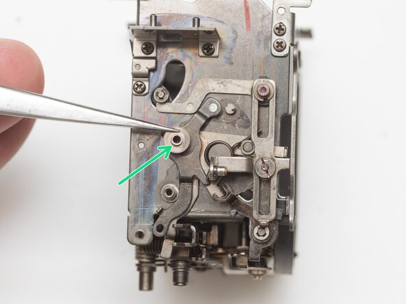

  28. Pentax Super Program Mirror Box Mechanism Service, Remove mirror return latch: crwdns2935265:028crwdnd2935265:01crwdnd2935265:03crwdne2935265:0 Pentax Super Program Mirror Box Mechanism Service, Remove mirror return latch: crwdns2935265:028crwdnd2935265:02crwdnd2935265:03crwdne2935265:0 Pentax Super Program Mirror Box Mechanism Service, Remove mirror return latch: crwdns2935265:028crwdnd2935265:03crwdnd2935265:03crwdne2935265:0
    • Remove one screw.
    • Remove one screw.
    • Remove one shim washer.
    • Note the rubber bumper on the pivot post. This should be removed and cleaned before reassembly.

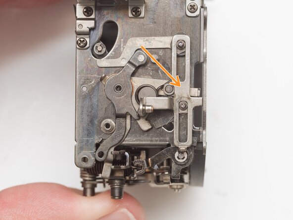

  29. Pentax Super Program Mirror Box Mechanism Service, Remove shutter release lever: crwdns2935265:029crwdnd2935265:01crwdnd2935265:02crwdne2935265:0 Pentax Super Program Mirror Box Mechanism Service, Remove shutter release lever: crwdns2935265:029crwdnd2935265:02crwdnd2935265:02crwdne2935265:0
    • Remove one screw.
    • Remove the bias spring.
    • Remove the brass bushing.
  30. Pentax Super Program Mirror Box Mechanism Service, Remove depth of field preview lever: crwdns2935265:030crwdnd2935265:01crwdnd2935265:03crwdne2935265:0 Pentax Super Program Mirror Box Mechanism Service, Remove depth of field preview lever: crwdns2935265:030crwdnd2935265:02crwdnd2935265:03crwdne2935265:0 Pentax Super Program Mirror Box Mechanism Service, Remove depth of field preview lever: crwdns2935265:030crwdnd2935265:03crwdnd2935265:03crwdne2935265:0
    • Unhook and remove the coil spring. It may be tacked in place with contact cement.
    • Remove one screw.
    • Remove the depth of field preview lever.
    • Remove the bushing.

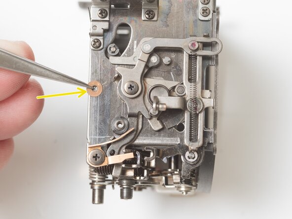

  31. Pentax Super Program Mirror Box Mechanism Service, Remove auto-aperture control lever: crwdns2935265:031crwdnd2935265:01crwdnd2935265:02crwdne2935265:0 Pentax Super Program Mirror Box Mechanism Service, Remove auto-aperture control lever: crwdns2935265:031crwdnd2935265:02crwdnd2935265:02crwdne2935265:0
    • Use a spanner wrench or u-bit to remove two nuts.
    • Lift off auto-aperture control lever.

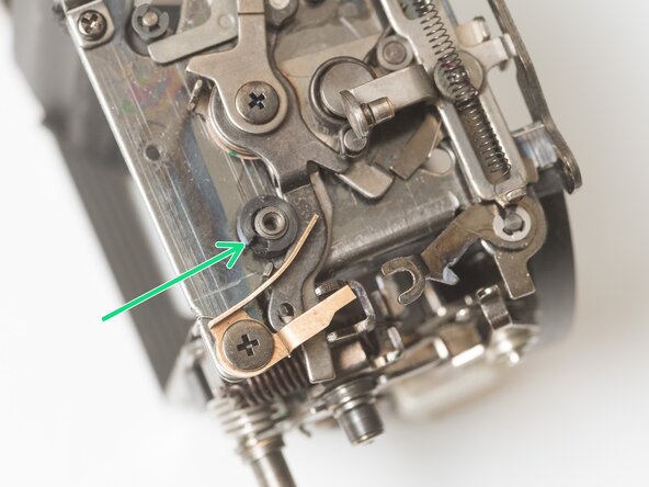

  32. Pentax Super Program Mirror Box Mechanism Service, Remove mirror flip-up lever: crwdns2935265:032crwdnd2935265:01crwdnd2935265:02crwdne2935265:0 Pentax Super Program Mirror Box Mechanism Service, Remove mirror flip-up lever: crwdns2935265:032crwdnd2935265:02crwdnd2935265:02crwdne2935265:0
    • Lift off mirror flip-up lever.
    • Remove shim washer.
    • Remove plastic bushing.

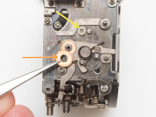

  33. Pentax Super Program Mirror Box Mechanism Service, Remove aperture stop-down lever: crwdns2935265:033crwdnd2935265:01crwdnd2935265:02crwdne2935265:0 Pentax Super Program Mirror Box Mechanism Service, Remove aperture stop-down lever: crwdns2935265:033crwdnd2935265:02crwdnd2935265:02crwdne2935265:0
    • Remove aperture stop-down lever.
    • Installation Notes: Ensure the lever foot is placed properly between the mirror flip-up spring and the mirror return lever during reassembly.

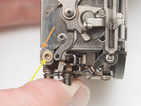

  34. Pentax Super Program Mirror Box Mechanism Service, Clean mirror box components: crwdns2935265:034crwdnd2935265:01crwdnd2935265:01crwdne2935265:0
    • Remove two old rubber bumpers.
    • Clean all pivots with isopropyl alcohol.
    • Clean all removed components with isopropyl alcohol.
  35. Pentax Super Program Mirror Box Mechanism Service, Reassembly Notes: crwdns2935265:035crwdnd2935265:01crwdnd2935265:01crwdne2935265:0
    • The mirror mechanism does not need lubrication to operate properly. Most moving interfaces run dry.
    • High friction latching points can be lubricated with a heavy moly grease to reduce wear.
    • Replacement rubber dampers are optional. Silicone tubing cut to length is good source.
