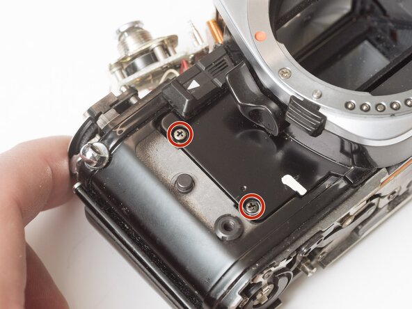

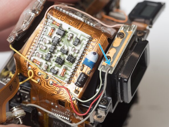

  4. Pentax Super Program Front Lens Board Removal, Remove top cover screws: crwdns2935265:04crwdnd2935265:01crwdnd2935265:03crwdne2935265:0 Pentax Super Program Front Lens Board Removal, Remove top cover screws: crwdns2935265:04crwdnd2935265:02crwdnd2935265:03crwdne2935265:0 Pentax Super Program Front Lens Board Removal, Remove top cover screws: crwdns2935265:04crwdnd2935265:03crwdnd2935265:03crwdne2935265:0
    • Remove two screws on either side of the eye piece.
    • Remove two screws on either side of the lens mount.
  5. Pentax Super Program Front Lens Board Removal, Remove top cover: crwdns2935265:05crwdnd2935265:01crwdnd2935265:03crwdne2935265:0 Pentax Super Program Front Lens Board Removal, Remove top cover: crwdns2935265:05crwdnd2935265:02crwdnd2935265:03crwdne2935265:0 Pentax Super Program Front Lens Board Removal, Remove top cover: crwdns2935265:05crwdnd2935265:03crwdnd2935265:03crwdne2935265:0
    • Remove one screw by the exposure compensation dial.
    • Use a spanner wrench to remove the lock nut under the advance lever.
    • Lift off the top cover slowly. It is still attached by one wire.
    • Unsolder one gray flash sync wire.

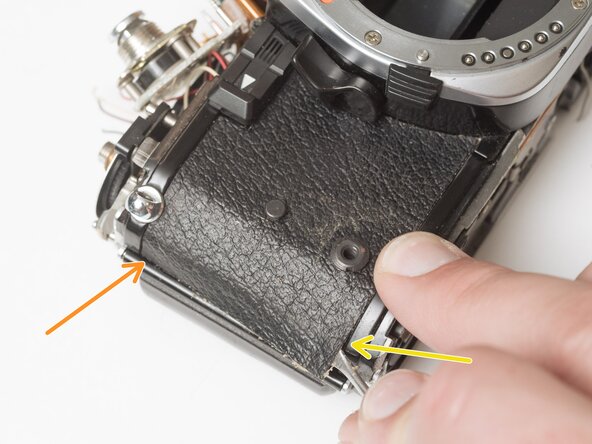

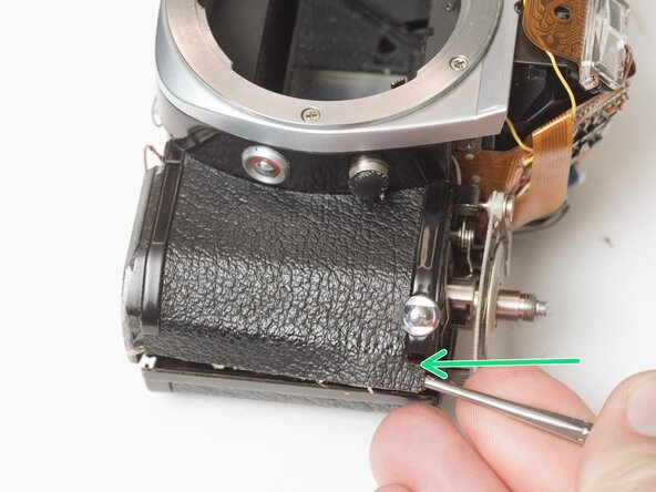

  7. Pentax Super Program Front Lens Board Removal, Remove front leatherette panels: crwdns2935265:07crwdnd2935265:01crwdnd2935265:03crwdne2935265:0 Pentax Super Program Front Lens Board Removal, Remove front leatherette panels: crwdns2935265:07crwdnd2935265:02crwdnd2935265:03crwdne2935265:0 Pentax Super Program Front Lens Board Removal, Remove front leatherette panels: crwdns2935265:07crwdnd2935265:03crwdnd2935265:03crwdne2935265:0
    • Use a nickel or other large coin to remove the hand grip.
    • Drip isopropyl alcohol along the edge of the leatherette to soften the adhesive.
    • Use a dull scraper to lift one corner and pull off the panel.
    • Repeat on the rewind side of the camera.
    • Installation Notes: Use contact cement to reattach the leatherette after the camera has been fully reassembled and tested.

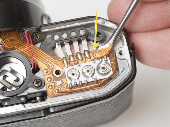

  8. Pentax Super Program Front Lens Board Removal, Detach flex PCB with adjustment pots: crwdns2935265:08crwdnd2935265:01crwdnd2935265:02crwdne2935265:0 Pentax Super Program Front Lens Board Removal, Detach flex PCB with adjustment pots: crwdns2935265:08crwdnd2935265:02crwdnd2935265:02crwdne2935265:0
    • Remove one M1.7 x 4.5 mm screw.
    • Remove one slotted screw.
    • Use isopropyl alcohol to soften the adhesive under the flex PCB.
    • Gently lift the PCB until it is free from the camera body.

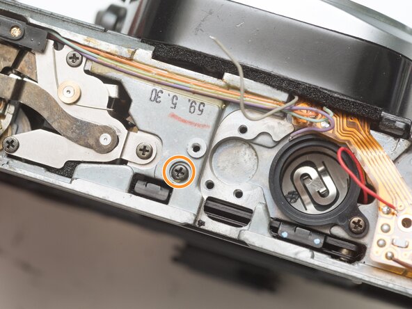

  9. Pentax Super Program Front Lens Board Removal, Unsolder wires under bottom plate: crwdns2935265:09crwdnd2935265:01crwdnd2935265:01crwdne2935265:0
    • Unsolder one red wire.
    • Unsolder one light blue wire.
    • Unsolder one orange wire.
    • Unsolder one purple wire.

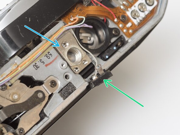

  10. Pentax Super Program Front Lens Board Removal, Remove tripod mount: crwdns2935265:010crwdnd2935265:01crwdnd2935265:02crwdne2935265:0 Pentax Super Program Front Lens Board Removal, Remove tripod mount: crwdns2935265:010crwdnd2935265:02crwdnd2935265:02crwdne2935265:0
    • Remove one M1.7 x 5 mm screw.
    • Remove one countersunk M1.7 x 5.5 mm screw.
    • Lift the contact terminal free from its seat.
    • Remove the tripod mount.

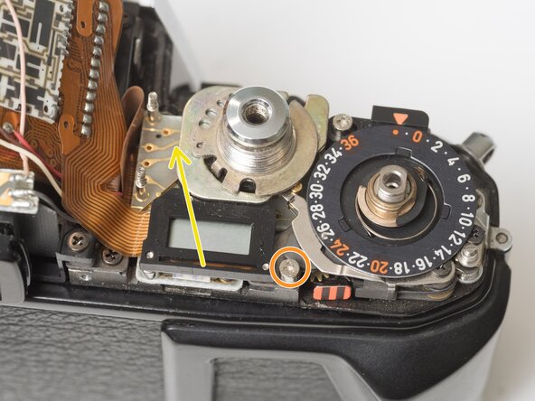

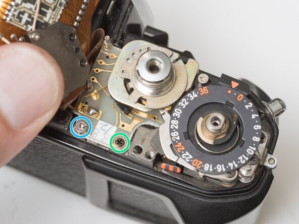

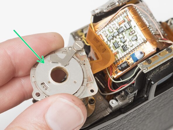

  12. Pentax Super Program Front Lens Board Removal, Detach mode dial unit: crwdns2935265:012crwdnd2935265:01crwdnd2935265:03crwdne2935265:0 Pentax Super Program Front Lens Board Removal, Detach mode dial unit: crwdns2935265:012crwdnd2935265:02crwdnd2935265:03crwdne2935265:0 Pentax Super Program Front Lens Board Removal, Detach mode dial unit: crwdns2935265:012crwdnd2935265:03crwdnd2935265:03crwdne2935265:0
    • Remove one M1.7 x 2.5 mm screw. It is only accessible when the mode dial is in the 'L' position.
    • Remove one crosshead screw.
    • Lift the LCD out of the way. It is still attached by a flex PCB.

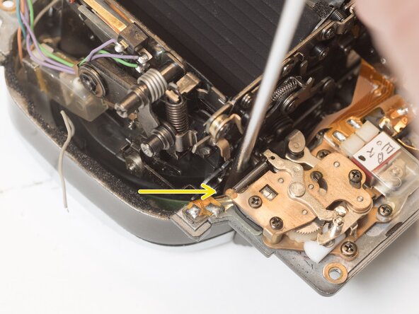

  13. Pentax Super Program Front Lens Board Removal, Unsolder flash sync and shutter wires: crwdns2935265:013crwdnd2935265:01crwdnd2935265:02crwdne2935265:0 Pentax Super Program Front Lens Board Removal, Unsolder flash sync and shutter wires: crwdns2935265:013crwdnd2935265:02crwdnd2935265:02crwdne2935265:0
    • Unsolder one gray wire.
    • Unsolder one brown wire.
    • Unsolder one white wire.

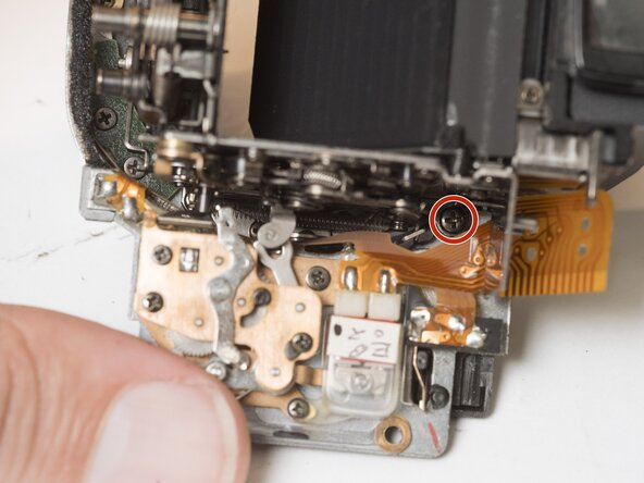

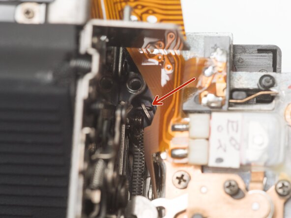

  14. Pentax Super Program Front Lens Board Removal, Unscrew front board: crwdns2935265:014crwdnd2935265:01crwdnd2935265:02crwdne2935265:0 Pentax Super Program Front Lens Board Removal, Unscrew front board: crwdns2935265:014crwdnd2935265:02crwdnd2935265:02crwdne2935265:0
    • Remove four M1.9 x 5 mm screws.
  15. Pentax Super Program Front Lens Board Removal, Unscrew mirror box: crwdns2935265:015crwdnd2935265:01crwdnd2935265:02crwdne2935265:0 Pentax Super Program Front Lens Board Removal, Unscrew mirror box: crwdns2935265:015crwdnd2935265:02crwdnd2935265:02crwdne2935265:0
    • Remove two M1.7 x 2.5 mm screws.
    • Remove one M1.7 x 3.5 mm screw under the bottom plate.
    • Some versions of the camera may have an additional screw under the tripod mount that needs to be removed.

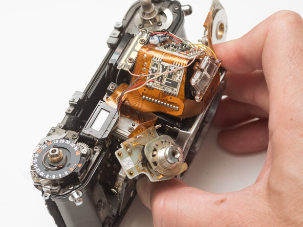

  16. Pentax Super Program Front Lens Board Removal, Remove mirror box and front board: crwdns2935265:016crwdnd2935265:01crwdnd2935265:02crwdne2935265:0 Pentax Super Program Front Lens Board Removal, Remove mirror box and front board: crwdns2935265:016crwdnd2935265:02crwdnd2935265:02crwdne2935265:0
    • Wind the shutter
    • Make sure the mode dial unit and ISO selector unit are free from their mounting points.
    • Wiggle the mirror box and front board free.
    • Watch for wire snags as you pull it free.
    • Check for loose shim washers on the front board and note their position.

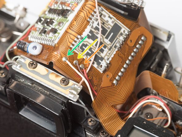

  18. Pentax Super Program Front Lens Board Removal, Unsolder Main PCB: crwdns2935265:018crwdnd2935265:01crwdnd2935265:01crwdne2935265:0
    • Unsolder one blue wire.
    • Unsolder one pink wire.
    • Unsolder two purple wires.
    • Unsolder one green wire.
  19. Pentax Super Program Front Lens Board Removal, Unsolder Main PCB: crwdns2935265:019crwdnd2935265:01crwdnd2935265:03crwdne2935265:0 Pentax Super Program Front Lens Board Removal, Unsolder Main PCB: crwdns2935265:019crwdnd2935265:02crwdnd2935265:03crwdne2935265:0 Pentax Super Program Front Lens Board Removal, Unsolder Main PCB: crwdns2935265:019crwdnd2935265:03crwdnd2935265:03crwdne2935265:0
    • Unsolder two yellow wires for the aperture resistor.
    • Unsolder one gray wire for flash sync.
    • Unsolder one red wire for metering cell power.
    • Unsolder one black wire for metering cell power.
    • Unsolder one pink wire for flash sync.

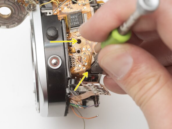

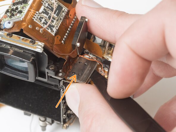

  20. Pentax Super Program Front Lens Board Removal, Detach flex PCB connection: crwdns2935265:020crwdnd2935265:01crwdnd2935265:02crwdne2935265:0 Pentax Super Program Front Lens Board Removal, Detach flex PCB connection: crwdns2935265:020crwdnd2935265:02crwdnd2935265:02crwdne2935265:0
    • Remove two M1.4 x 2 mm screws.
    • Use a spudger to gently pry off the connector plate.
    • Remove the silicone insulating pad.

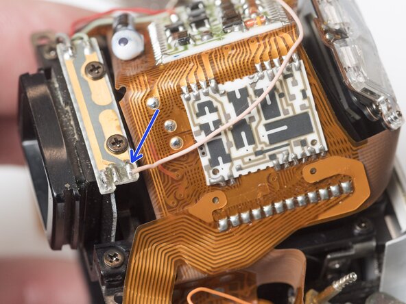

  21. Pentax Super Program Front Lens Board Removal, Detach viewfinder LCD: crwdns2935265:021crwdnd2935265:01crwdnd2935265:01crwdne2935265:0
    • Remove two M1.4 x 1.6 mm screws.
    • Look for shim washers when removing and note their position.

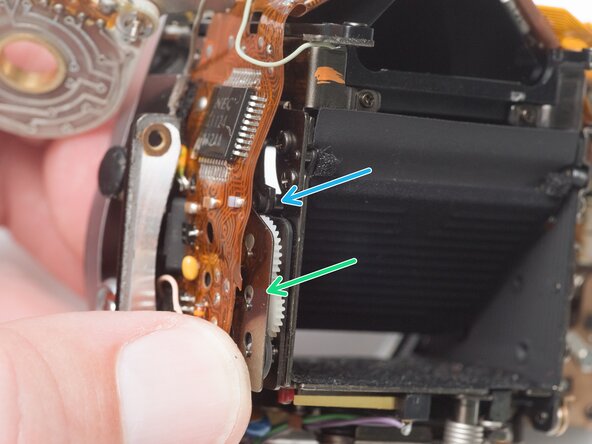

  22. Pentax Super Program Front Lens Board Removal, Remove mirror governor: crwdns2935265:022crwdnd2935265:01crwdnd2935265:03crwdne2935265:0 Pentax Super Program Front Lens Board Removal, Remove mirror governor: crwdns2935265:022crwdnd2935265:02crwdnd2935265:03crwdne2935265:0 Pentax Super Program Front Lens Board Removal, Remove mirror governor: crwdns2935265:022crwdnd2935265:03crwdnd2935265:03crwdne2935265:0
    • Loosen one M1.7 x 4.5 mm screw but leave it in place.
    • Remove two M1.7 x 1.6 mm screws.
    • Remove the mirror governor.
    • Remove one plastic bushing.

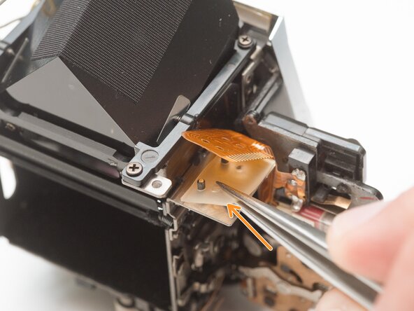

  24. Pentax Super Program Front Lens Board Removal, Detach front flex PCB: crwdns2935265:024crwdnd2935265:01crwdnd2935265:02crwdne2935265:0 Pentax Super Program Front Lens Board Removal, Detach front flex PCB: crwdns2935265:024crwdnd2935265:02crwdnd2935265:02crwdne2935265:0
    • Lift flex PCB off of mounting posts.
    • Remove silicone insulator pad.
