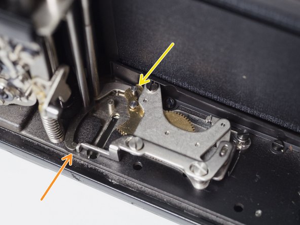

  19. Pentax Spotmatic Slow Speed Governor Cleaning, Remove slow speed governor: crwdns2935265:020crwdnd2935265:01crwdnd2935265:02crwdne2935265:0 Pentax Spotmatic Slow Speed Governor Cleaning, Remove slow speed governor: crwdns2935265:020crwdnd2935265:02crwdnd2935265:02crwdne2935265:0
    • Remove two 2.8 mm flat head screws.
    • Installation Notes: Ensure that the pallet rod and delay rod are properly coupled to the slow speed governor.
  20. Pentax Spotmatic Slow Speed Governor Cleaning, Clean and lubricate slow speed governor: crwdns2935265:021crwdnd2935265:01crwdnd2935265:03crwdne2935265:0 Pentax Spotmatic Slow Speed Governor Cleaning, Clean and lubricate slow speed governor: crwdns2935265:021crwdnd2935265:02crwdnd2935265:03crwdne2935265:0 Pentax Spotmatic Slow Speed Governor Cleaning, Clean and lubricate slow speed governor: crwdns2935265:021crwdnd2935265:03crwdnd2935265:03crwdne2935265:0
    • Clean the slow speed governor by soaking it in isopropyl alcohol to loosen dirt and grime.
    • Actuate the gear train repeatedly to work contaminates free. An ultrasonic cleaner can also be used if available.
    • Once dry, lubricate six pivot points with shutter oil to ensure consistent operation.
